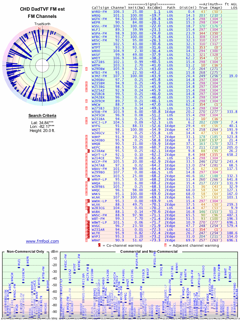

I think I have found the source of interference to WLOS, real channel 13. It is from WYRD FM, which is very close to your location. I don't have your exact address, but this is the FM Fool report I did from an estimate of your location (report also in attachment):
http://www.fmfool.com/modeling/tmp/e...9/Radar-FM.png
You can do your own report here:
WYRD is probably causing fundamental overload and its second harmonic falls right in the middle of CH 13.
WYRD FM 106.3 MHz x 2 = 212.6 MHz
CH 13, 210 to 216 MHz
You will need an FM filter or two in series, and you must ground the coax with a grounding block connected to the house electrical system ground to reduce interference.
FM filter, use one or two in series:
A HLSJ, HI & LINE ports, can also be used as an FM filter:

Thanks for looking that up, I had no idea FM could cause issues.
See Deyoung? I am the house directly across the street! I am 0.4 miles from the FM tower according to that site you linked.
