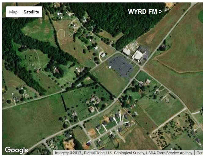

I think I have found the source of interference to WLOS, real channel 13. It is from WYRD FM, which is very close to your location. I don't have your exact address, but this is the FM Fool report I did from an estimate of your location (report also in attachment):
http://www.fmfool.com/modeling/tmp/e...9/Radar-FM.png
http://forum.tvfool.com/attachment.p...1&d=1488400304
You can do your own report here:
WYRD is probably causing fundamental overload and its second harmonic falls right in the middle of CH 13.
WYRD FM 106.3 MHz x 2 = 212.6 MHz
CH 13, 210 to 216 MHz
You will need an FM filter or two in series, and you must ground the coax with a grounding block connected to the house electrical system ground to reduce interference.

CHD Dad 1-Mar-2017 3:13 AM
Thanks for looking that up, I had no idea FM could cause issues.
See Deyoung? I am the house directly across the street! I am 0.4 miles from the FM tower according to that site you linked.
That map is old even though it says 2017, those 3 Cypress behind house are now a row and that big field to the left is becoming a subdivision/church. We're actually building a new house on same property along Satterfield and parents are moving into the house on map. Where new house sits also has a row of Cypress blocking views from Satterfield and the farm beyond. That could be even harder for an antenna, it sits down in a little valley vs. current house. It's at least 20+ feet lower in elevation. I'll be installing an antenna there as well.

I edited the map. Please see the PM I sent to you.
