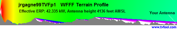

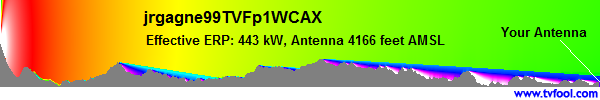

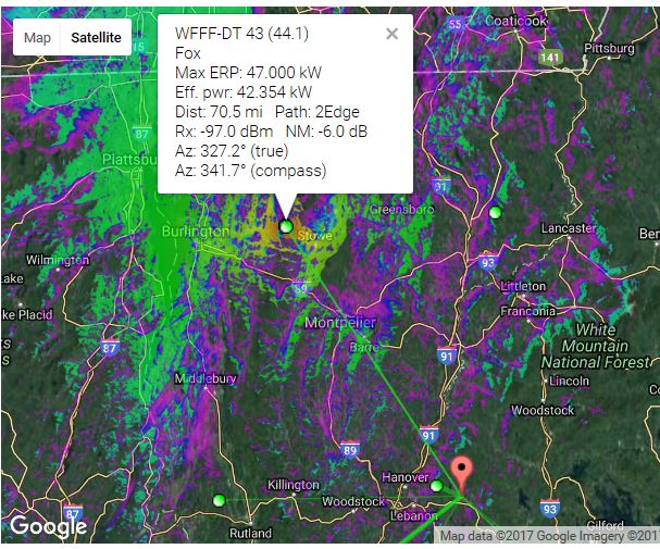

The signal path for WFFF is very similar to the WCAX signal path, but WFFF is running much less power and its antenna is a little lower on a separate tower.
You are on the extreme fringe of coverage for WFFF
A closeup of WFFF coverage; purple is very weak, no color is dead zone
1) Given that reception lasted for 20+ hours could this have been a "tropospheric" reception phenomenon?

I vertically stacked two SolidSignal HDB8x's,
An 8-bay antenna has a horizontal beamwidth that is more narrow than a 4-bay, but its vertical beamwidth is the same as the 4-bay.
When you have a vertical stack of two 8-bays, the vertical beamwidth is even more narrow than one 8-bay. This means the azimuth aim AND the elevation aim are very critical. It might be necessary to tilt the top of the antenna back to aim slightly above horizontal for peak signal.
One of my antenna test locations has a clear path across water, but I found it necessary to tilt my 4-bay for max signal.

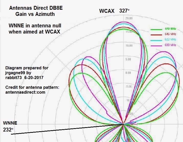

In my latest experiment, I combined a Stellar Labs 30-2476 VHF yagi with a DB8e 8-bay using a UVSJ combiner (Stellar labs 33-2230 UVSJ). Real channel 25 (WNNE) is strong enough that it is separately received by both antennas, even though I point them 90-degrees off from the Real-25 tower to pick up Burlington stations. I confirmed this by separately removing UHF and VHF feeds to the UVSJ, and I receive Real-25 in both cases. Strangely, when both feeds to the UVSJ are populated, the UVSJ does not allow Real-25 to pass through to the output.
Any thoughts on what might be going on here? Is this some form of destructive interference where some very low amplitude CH-25 signal passes through the VHF-pass filter and destructively interferes with the CH-25 coming through the UHF-pass section?
Is this an example of UVSJ's "not always doing what they're supposed to" and why I've seen several people on this forum recommend using separate coax runs and an A/B switch for UHF and VHF instead of using a UVSJ combiner?

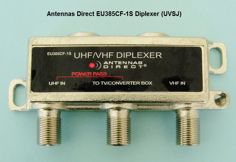

The UVSJ you used is an unknown quantity. I've not made nor have I ever seen a detailed analysis of its performance.

Given the limited availability since so many ones from the past are NLA, ours is the only one currently on the market that I have current performance data on. I tested a number of them 5-6 years ago but haven't revisited them since most of them have been discontinued.

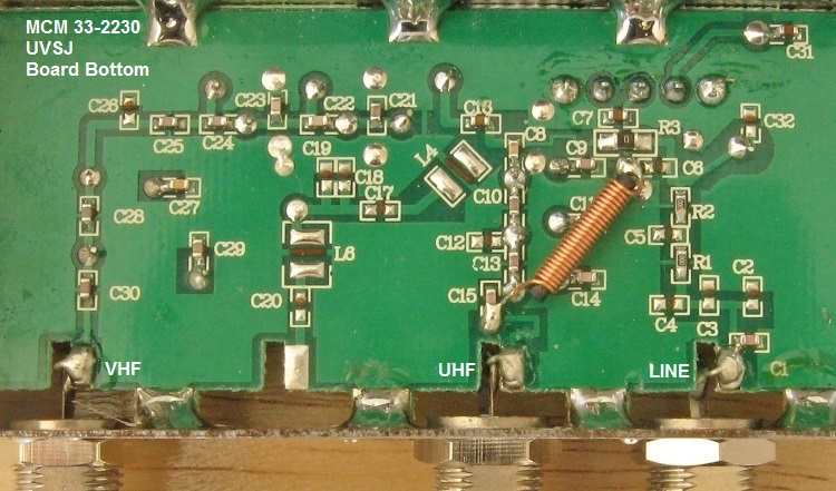

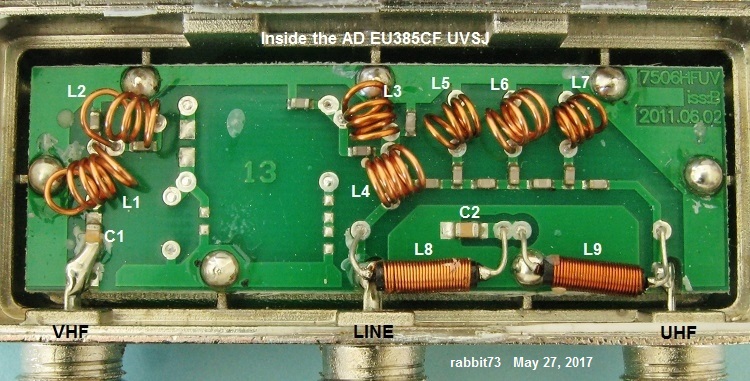

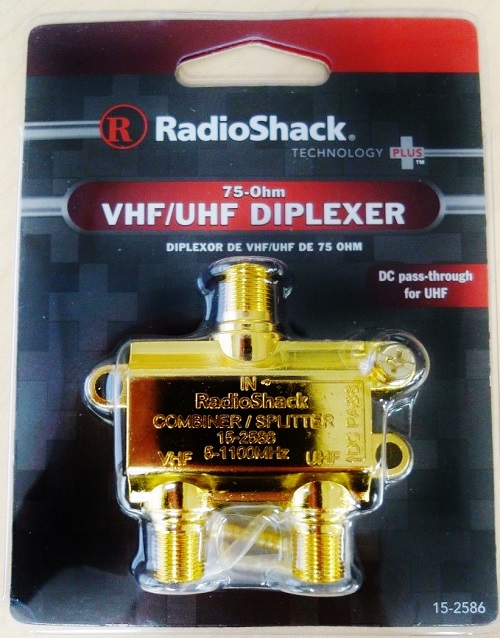

You are expecting too much and not giving even the best UVSJ a chance. When you aim your DB8e at Burlington, you are placing WNNE perfectly in the antenna null, making it much weaker. That is what you would do if you wanted to reject WNNE, not receive it.
As ADTech said, their UVSJ is the only one currently available with known performance.
There are a few Radio Shack 15-2586 UVSJs still left; the last one I measured did well.
I opened up the MCM 33-2230 and wasn't impressed, but haven't measured it yet. They are using an all purpose board modified for use as a UVSJ, with a lot of empty pads for components.
I think it is possible. You have a very weak CH-25 signal coming from BOTH antennas.
Is this an example of UVSJ's "not always doing what they're supposed to" ?
It's an example of trying to make a UVSJ do what it was never designed to do.
That can work well if the antennas are aimed at the transmitters.
If you want reliable reception of WNNE, the antenna must be aimed at WNNE.

I did some more tests this evening, (all in the last 30 minutes before sunset, for what it's worth). It seems that the 33-2230 UVSJ is greatly attenuating my UHF signals. I was using my Solid Signal HDB91X UHF yagi mounted at 30 feet AGL, with a CM-7778 pre-amp at the mast. In Configuration#1, I sent the HDB91X signal directly to the pre-amp (no UVSJ). In Configuration #2, I combined the HDB91X with the StellarLabs 30-2476 VHF yagi using the UVSJ, and then fed that to the pre-amp. Here are the SNRs as reported by my Sony Bravia (typically need SNR>14 to receive channel):
Real Ch____Config#1 (no UVSJ)___Config#2 (with UVSJ + VHF yagi)
13___________0 (no VHF ant)________18
14___________20__________________15
22___________19__________________6
24___________24__________________9
25___________21__________________8
32___________18__________________10
50___________29__________________17
I repeated configuration #1 a second time and confirmed this wasn't a temporal effect. I also did configuration #2 again, but left the VHF input to the UVSJ empty. The results were the same as with the 30-2476 VHF yagi feeding the UVSJ (except of course no Real 13 reception). Leaving the UVSJ out of the picture (HDB91X and pre-amp only) and signal strengths seem to be unchanged as i write this, even though it is now over 1 hour after sunset. One thing I didn't try was to see how Real13 is affected by the UVSJ. It comes in with the UVSJ (SNR=18), but I didn't measure the signal strength if I use the VHF yagi directly, with no UVSJ. Maybe it would be a fair bit higher. Also, FWIW, there is about 100 feet of RG-6 between my mast mounted pre-amp and the power inserter.
It would seem that I should try a different brand of UVSJ. I would rather like to avoid two lines and an A/B switch.
Last edited by jrgagne99; 21-Jun-2017 at 1:51 AM. Reason: tried to improve table formatting
Old 21-Jun-2017, 2:11 AM   #57
Thanks for the test results.
