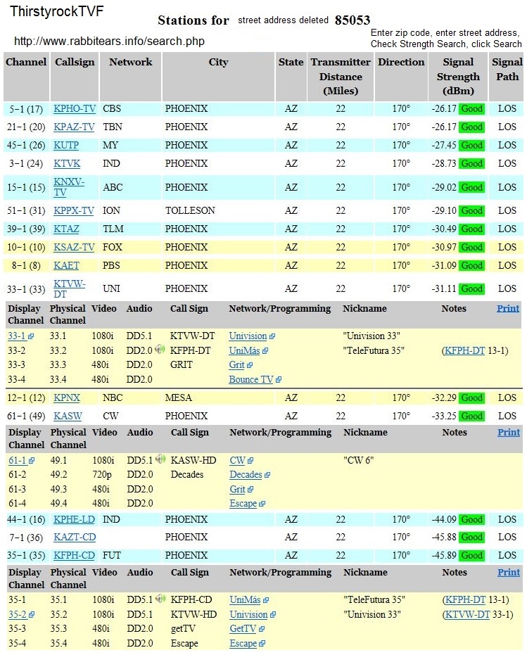

There are no real/physical channels higher than 51. It is possible that your tuner memory has become corrupted, in which case you can clear it with a double rescan. The other possibility is tuner overload.
Grit is supposed to be on KTVW real channel 33, virtual channel 33.3 AND on KASW real channel 49, virtual channel 61.3.
Escape is supposed to be on KASW real channel 49, virtual channel 61.4 AND on KFPH real channel 35, virtual channel 35.4.
