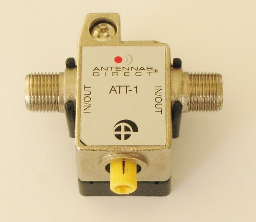

In addition to following the advice by ADTech, I suggest you try inserting an attenuator in the coax line between the antenna and the tuner to see if overload is a problem. Also try inserting an FM filter to attenuate your local FM signals.
A splitter can be used as an attenuator; 3 dB for a 2-way splitter, 7 dB for a 4-way splitter. There is also a variable attenuator available:
http://forum.tvfool.com/attachment.p...1&d=1480972452
The ATT-1 knob has 3-3/4 turns, so I put a mark on the knob with an ultra fine point Sharpie to count the turns. Clockwise rotation increases the signal; minimum attenuation at full clockwise rotation. When I use mine to make tuner sensitivity tests, I start there, and rotate the knob counterclockwise to increase the attenuation for the test.
http://www.avsforum.com/forum/186-co...l#post48473881
