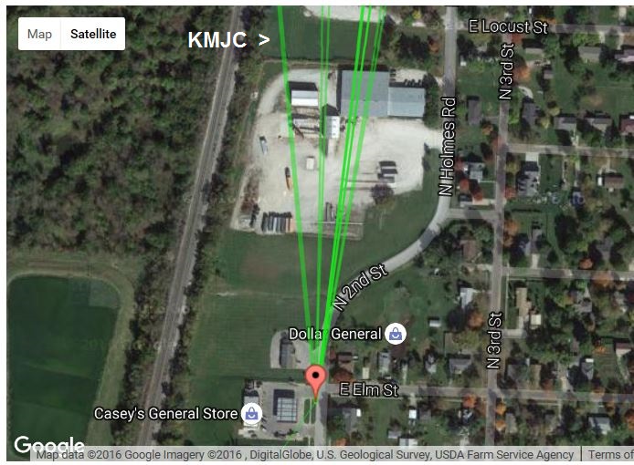

I don't know your exact address, but this is what I see:
You can do your own green lines here by moving the cursor (drag and drop) to the antenna location.
Have you tried another TV, another antenna, or another antenna location?
The only other thing I can think of is that the tvfool report is wrong and KMJC has a very directional transmitting antenna that sends very little signal in your direction.

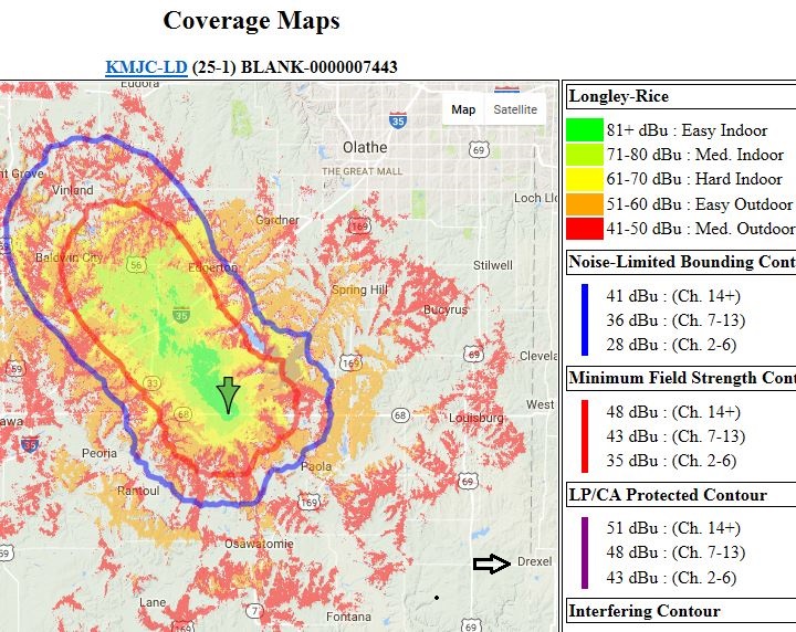

If you click on KMJC in your report it says 15 kW ERP.
http://www.tvfool.com/?option=com_wr...dALLTV%26n%3d1
but rabbitears.info says 1.1 kW ERP. The directional antenna sends less than 4% of that in your direction. We call that a "peanut whistle."
http://www.rabbitears.info/tvq.php?r...s&facid=184373
Drexel is in a dead zone for the KMJC signal.

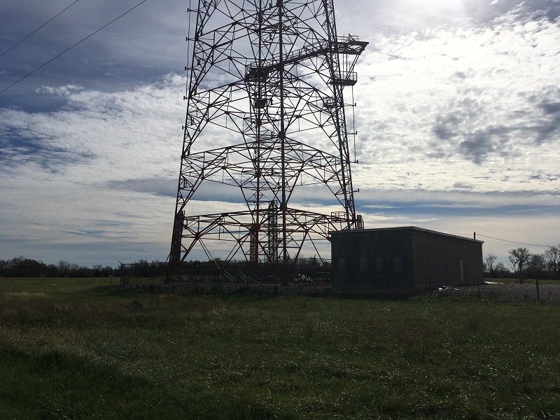

It appears they have rectified whatever issues they were having with the transmitter in Louisburg. Friday night, channel 22 (virtual 25) lit up with 100% signal strength and signal quality on my HD Homerun OTA tuner. Not sure what was wrong before, but at any rate, it's working GREAT now and it's added 12 channels to the over-the-air lineup for thousands of people in the extreme south Kansas City area/northern Southeast Kansas area. Turns out the tower is only 9.2 miles from my house, so I drove up there Saturday morning and took some photos of the tower.

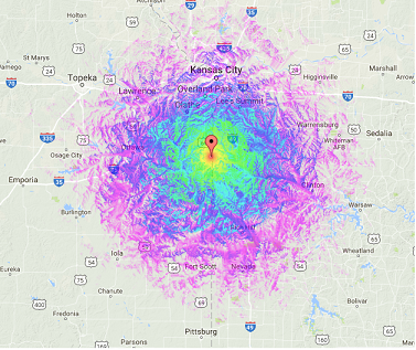

This appears to be the footprint now:
