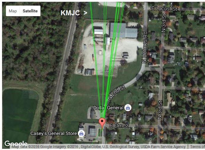

I don't know your exact address, but this is what I see:
http://forum.tvfool.com/attachment.p...1&d=1474500080
You can do your own green lines here by moving the cursor (drag and drop) to the antenna location.
Have you tried another TV, another antenna, or another antenna location?
The only other thing I can think of is that the tvfool report is wrong and KMJC has a very directional transmitting antenna that sends very little signal in your direction.

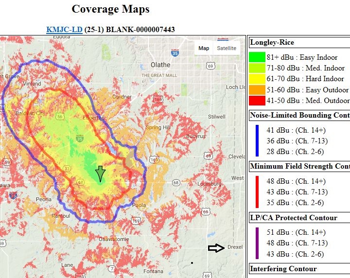

If you click on KMJC in your report it says 15 kW ERP.
http://www.tvfool.com/?option=com_wr...dALLTV%26n%3d1
but rabbitears.info says 1.1 kW ERP. The directional antenna sends less than 4% of that in your direction. We call that a "peanut whistle."
http://www.rabbitears.info/tvq.php?r...s&facid=184373
Drexel is in a dead zone for the KMJC signal.
