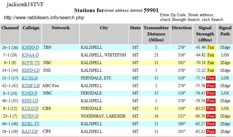

I went to rabbitears.info and entered my estimate of your address. If you click on the callsign there, you will see the networks. The callsigns will be listed in virtual channel number order, not strength as in a tvfool report.
http://www.rabbitears.info/search.php
Then I added Strength Search and antenna height. That gave me this in decreasing signal strength order. I deleted your street address.

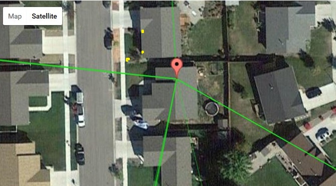

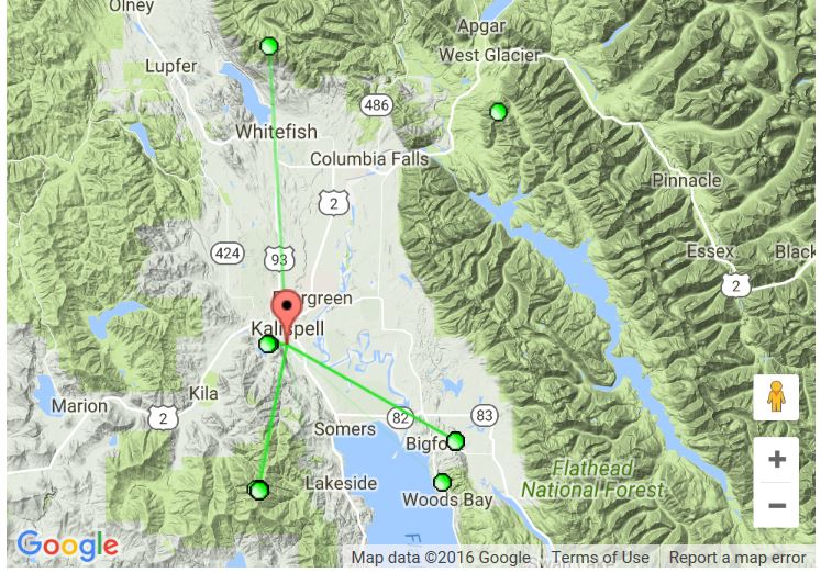

Then I went to the tvfool interactive map browser to see the green signal lines.'
If you mount your antenna at the right spot, the tree behind the house to the south will not block the 191 or 119 path.

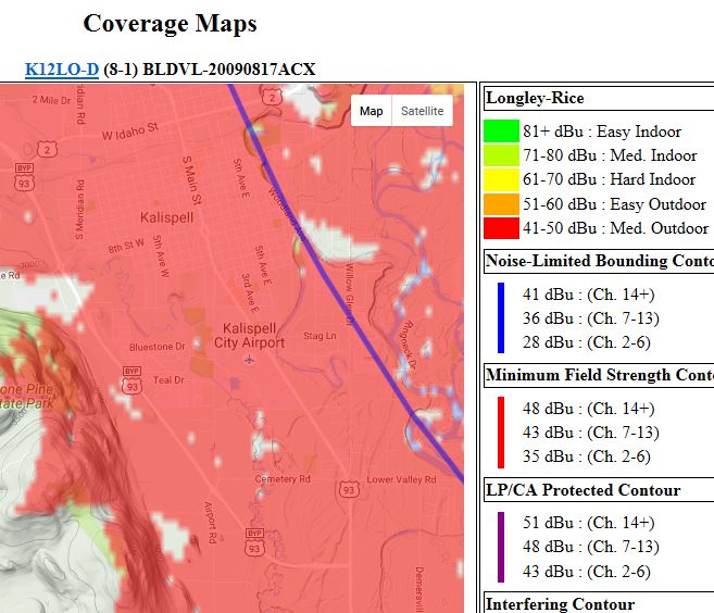

Oh, Wow; I missed that and went by the noise Margin number in the report and the dBm number from rabbitears.info.
For some odd reason the FCC Longley-Rice K12LO Coverage Map supports the tvfool report; is it also wrong?
They are mathematical simulations only.
The information missing from the simulation is the ambient background noise level on the channel of interest which, without a field measurement, can only be estimated. The simulations assume that the noise level is -106.2 dBm, the perfect case. Practical experience has shown that the ambient noise level in the high-VHF band may be anywhere from 5 to 20+ dB higher than the assumption. Subtract that from the calculated noise margin and and you'll see why I'm pessimistic about receiving channel 12.

My neighbor is getting channel 9 next door from each of the spots I put a yellow dot with the same antenna.

To find the sweet spot I walk around with a test antenna in one hand and my signal level meter in the other hand. The sweet spot will vary with frequency; find the best spot for your weakest desired channel and hope that the stronger channels are still OK.
