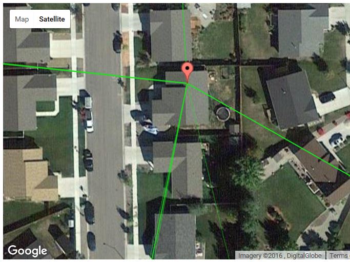

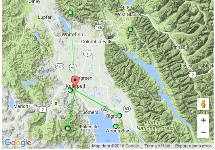

Then I went to the tvfool interactive map browser to see the green signal lines.'
http://forum.tvfool.com/attachment.p...1&d=1478225791
If you mount your antenna at the right spot, the tree behind the house to the south will not block the 191 or 119 path.

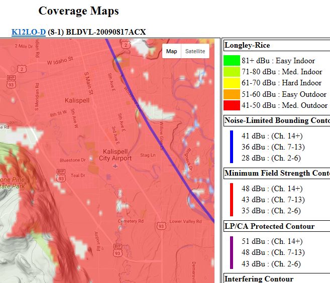

rabbit73 5-Nov-2016 12:24 AM
1 Attachment(s)
Oh, Wow; I missed that and went by the noise Margin number in the report and the dBm number from rabbitears.info.
For some odd reason the FCC Longley-Rice K12LO Coverage Map supports the tvfool report; is it also wrong?
http://forum.tvfool.com/attachment.p...1&d=1478307815
http://www.rabbitears.info/contour.p...14.03869444444

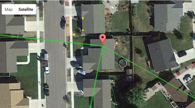

rabbit73 5-Nov-2016 7:42 PM
1 Attachment(s)
My neighbor is getting channel 9 next door from each of the spots I put a yellow dot with the same antenna.
Is he using a preamp?
http://forum.tvfool.com/attachment.p...1&d=1478374853

Does that site your using tell you where the sweet spot is? I don't understand how to use that, is there a video tutorial somewhere?
No, it just lists the channels, gives the green signal lines, and gives coverage maps. I can walk you through it step by step with an example if you so desire. I use the tvfool interactive map browser:
To find the sweet spot I walk around with a test antenna in one hand and my signal level meter in the other hand. The sweet spot will vary with frequency; find the best spot for your weakest desired channel and hope that the stronger channels are still OK.
http://forum.tvfool.com/attachment.p...5&d=1466633825
http://forum.tvfool.com/attachment.p...6&d=1446858514
