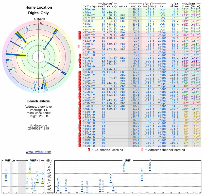

You DO have some strong FM signals that might interfere with the reception of KELO CBS and KSFY ABC. I did this FM signal report based on an estimate of your location from your tvfool report which was only resolved to block level:
http://www.fmfool.com/modeling/tmp/5...e/Radar-FM.png

I see a lot of trees in your area; trees block TV signals. Do you have any trees or other buildings in the signal path from 164 degrees magnetic?

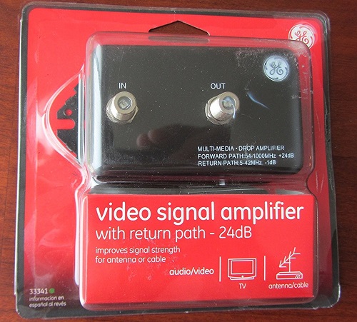

I am wondering if an antenna amplifier on the antenna itself will help me out??
Maybe, but it might be overloaded by K50DG. And you certainly don't need a preamp AND the GE 24 dB amp. Try the HLSJ as an FM filter first.

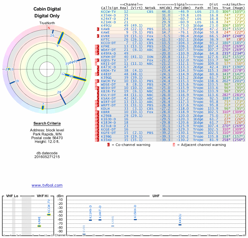

What are the callsigns of 35 an 21 at the cabin, K35KH and K21HX? They seem quite strong.
I am using a homemade antenna as described
I don't see the description of the antenna.
If there are trees in the path from 73 degrees magnetic, that might be the problem.
Your reports for the cabin are only resolved to block level instead of based on coordinates; they might not be too accurate.

That antenna is suitable for K35KH, K24KT, and K21HX, which are UHF channels. It might even pick up KCCW which is a VHF-High channel that is stronger.

K50DG Fox real channel 50 is your strongest channel. It might be causing overload of your amp or tuner; it certainly doesn't need any more amplification.
K50DG Noise Margin 59.1 dB.
59.1 dB NM + 5 dB UHF ant gain est - 6 dB coax loss + 24 dB amp = 82.1 dB NM; overload

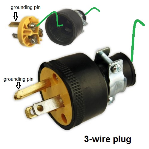

Sometimes when I am making a temporary test I connect the coax shield to a cold water pipe that I know is grounded, Another temporary way is to connect to the grounding pin socket of a properly wired 3-wire receptacle. To do that, I connect a wire to only the grounding pin of a spare 3-wire plug with nothing connected to the blades of the plug.
