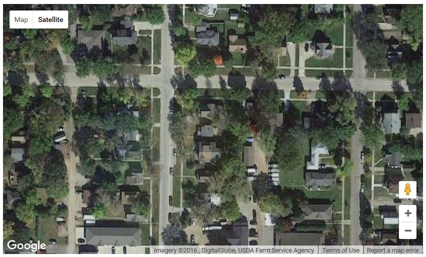

I see a lot of trees in your area; trees block TV signals. Do you have any trees or other buildings in the signal path from 164 degrees magnetic?

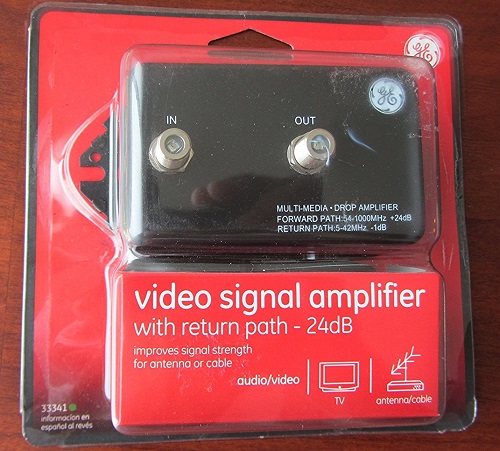

I am wondering if an antenna amplifier on the antenna itself will help me out??
Maybe, but it might be overloaded by K50DG. And you certainly don't need a preamp AND the GE 24 dB amp. Try the HLSJ as an FM filter first.

Does the antenna amplifier have a separate port for FM vs. UHF/VHF? Maybe that is not a fix because I want to block out FM and VHF-Lo?? The reason I ask is that I am using a homemade antenna as described at our MN cabin with an antenna amplifier. I'm typically picking up 13 - 16 channels. I'm wondering if I may have FM issues there as well because I have a hard time with a significant signal at different times during the day. I've attached a copy of the TV Fool report for both TV and FM signal for this location. The antenna is mounted on a 12 foot mast fastened to a fence post. (Reception did not seem to make any difference from higher up on roof line to this height/area). I have the most trouble with channel 35 and some low signal strength on 21. There are, of course, lots of trees there but the aim is almost down the driveway. I do notice difference in summer and winter somewhat. Just thought I would include this as I might as well order a couple of them. Thanks again!

59.1 dB NM + 5 dB UHF ant gain est - 6 dB coax loss + 24 dB amp = 82.1 dB NM; overload

I did purchase a RCA Digital Signal Preamplifier #TVPRAMP1Z
Try the RCA preamp in place of the GE amp, with and without the HLSJ FM filter, WITH the coax grounded with a grounding block. If the results are not satisfactory, substitute a CM 3410 and FM filter where the GE amp was located. Save the RCA preamp for the cabin experiments.
