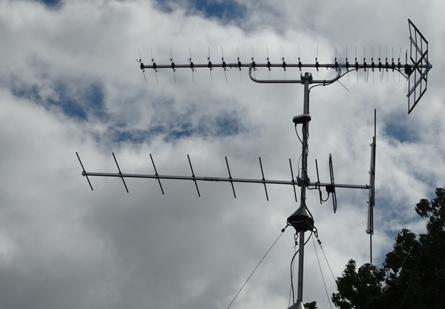

If you do decide to go with the two antenna suggestion, I would combine them with the RCA PREAMP1R amp, it has an input for VHF and for UHF separately. It's fairly low in noise and will boost your signal substantially.
I use the two antenna solution with the Stellar Labs 30-2476 and a Solid Signal HDB91X and combine them with the RCA preamp, works great and for very little money. Total less than $100. The HDB91X is on sale right now for 39.99:
http://www.solidsignal.com/pview.asp?p=HDB91X
http://www.solidsignal.com/pview.asp?p=TVPRAMP1R
I got mine at Amazon, only $21 and free shipping too:
https://www.amazon.com/s/ref=nb_sb_n...s=RCA+Preamp1r
