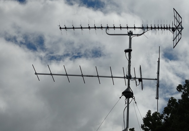

If you do decide to go with the two antenna suggestion, I would combine them with the RCA PREAMP1R amp, it has an input for VHF and for UHF separately. It's fairly low in noise and will boost your signal substantially.
I use the two antenna solution with the Stellar Labs 30-2476 and a Solid Signal HDB91X and combine them with the RCA preamp, works great and for very little money. Total less than $100. The HDB91X is on sale right now for 39.99:

Thanks I'll look into those. Another one I was looking at and was considering was the Winegard HD 7698P. Any thoughts on that antenna? Is it cost the main reason you are selecting the one above?
I think I will definitely run a pre-amp either way. We will be having multiple TV's. We are building the house so not sure how long the coax run will be but it will be long enough I think. Thank you.
rabbit73 26-Sep-2016 2:59 PM
That is most likely their reason. If you want an all-in-one combo antenna, the HD7698P would be suitable with a CM7777 preamp.
Your antenna must be mounted in a location that does not have trees in the signal path.
The preamp should be mounted near the antenna, and the power inserter should be inside. If the coax run from the preamp to the power inserter is less than 100 feet, RG6 coax with a copper clad steel center conductor will be OK. For longer runs, use RG6 with a solid copper center conductor, because it has less voltage drop for the DC needed to run the preamp.
