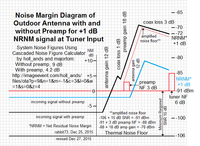

I was looking for the preamp with the lowest noise figure, as much like the fact you can't amplify into existence a signal that isn't there, noise introduction is also not removable once introduced.
That is correct, the preamp noise reduces the SNR of the signal coming from the antenna. But it is more than made up for by the reduction in the system noise figure which makes it possible to receive signals with a lower NM. Otherwise, there would be no point in using a preamp.
If I can get a low noise preamp with enough strength to cover my distribution strength needs as well, that should eliminate the noise introduction of a distribution amp, should it not?
Yes, when you are using a preamp AND a distribution amp, the noise from the distribution amp (IF you really need it) will be buried in the amplified noise floor as is the tuner noise.

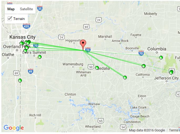

Initially I'm going to point both panels west for best signal on the KC stations. If that works well, with signal margin to spare, I may try pointing the second panel at Columbia. It has one VHF Hi station that I don't expect to pull in, but all the rest are UHF. It would be neat to get the stations from both cities.
That might not work too well; you will just have to try it. There are 3 problems with that:
1. You will lose about 3 dB of antenna gain for signals from the west, because there will only be one panel aimed in that direction.
2. You will lose the front-to -back ratio of the DB8e that protects the preamp from partial overload. Partial overload can produce distortion products that might mask your weakest signals because they raise the noise floor.
3. In spite of what marketing departments say, aiming the two panels in different directions doesn't always work. The same signals from each antenna can interfere with each other if they don't arrive at the combining point in phase (at the same instant). According to ADTech, it has the best chance of working if the two directions are at a right angles (90 degree apart).
It might not be as neat as you think it will be.

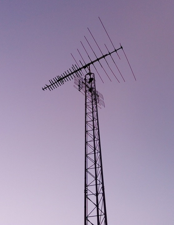

So I'm working this in steps. More progress tonight. Antenna is further up the tower.
I'm a little squeamish about heights, but it's getting easier to climb the tower each time I go up. I'll have to go a few more times before all is said and done.
It's about 10 feet taller than before. I was able to watch the signal strength during some weather (before raising it further to the pictured height). wdaf and kctv cut out in rain, and stayed out until after the tree leaves were dry (antenna was not clear of the trees in the front yard).
Currently, the antenna is nearly above the tops of the nearest trees. The absolute peak of the tower would be almost level with the tops.
Still no preamp installed. It came in the mail the other day, but I want to watch my signal for a few days first, with a single tuner installed.
Signal strength on this DB8e (unamplified, connected to single device) is equal, to slightly better than the old antenna on the top (preamped, distribution amped, and connected to whole house (3 tvs, 3 dvrs).

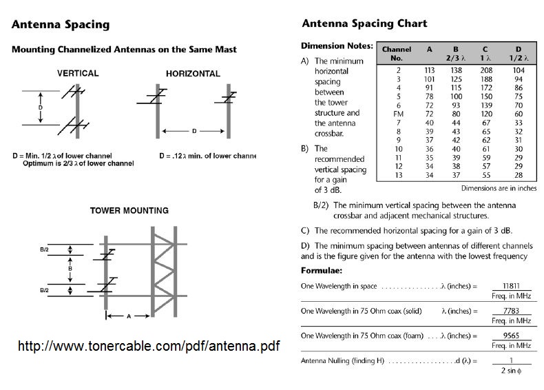

How close can it get to the top antenna before they affect each other? Ultimately, once the DB8e proves reliable, it will get connected to all the tv's in the house, and I will experiment with turning the top antenna east and seeing what comes in. Does the direction they are pointed have any connection to how close they can be?
crashHD is offline   Reply With Quote

I don't know if it was right, but I just clamped the antenna directly to the leg of the tower.
It's been discussed, that removing a bowtie's reflectors makes it bidirectional. I am considering that, but does anyone know if removing reflectors has ramifications on signal strength, or mulitpath rejection? I'm not willing to give up much signal, and my signal path is unfortunately skimming a few treetops, so any reduction in mulitipath resistance may be a heavy penalty.
The general rule is 1/2 wavelength for the lowest frequency used. See the attachment.
Yes, when the elements are parallel to each other the interaction is greatest because the coupling is the greatest. When the elements are at right angles, the interaction is minimum.
I am considering that, but does anyone know if removing reflectors has ramifications on signal strength, or multipath rejection?
Removing the reflectors makes the antenna bi-directional. but costs you about 3 dB in gain; there is no free lunch.
Removing the reflectors probably will not change the multipath caused by the scattering of the signal as it passes through the trees, but the antenna will be less able to reject multipath reflections from other directions.
For minimum interaction, the tower should be behind the reflector; IOW
incoming signal > bowtie elements > reflector > tower
