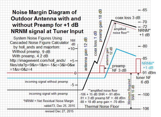

rabbit73 8-Aug-2016 2:44 PM
2 Attachment(s)
I was looking for the preamp with the lowest noise figure, as much like the fact you can't amplify into existence a signal that isn't there, noise introduction is also not removable once introduced.
That is correct, the preamp noise reduces the SNR of the signal coming from the antenna. But it is more than made up for by the reduction in the system noise figure which makes it possible to receive signals with a lower NM. Otherwise, there would be no point in using a preamp.
If I can get a low noise preamp with enough strength to cover my distribution strength needs as well, that should eliminate the noise introduction of a distribution amp, should it not?
Yes, when you are using a preamp AND a distribution amp, the noise from the distribution amp (IF you really need it) will be buried in the amplified noise floor as is the tuner noise.

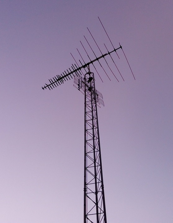

crashHD 14-Aug-2016 2:05 AM
1 Attachment(s)
So I'm working this in steps. More progress tonight. Antenna is further up the tower.
http://forum.tvfool.com/attachment.p...1&d=1471174508
I'm a little squeamish about heights, but it's getting easier to climb the tower each time I go up. I'll have to go a few more times before all is said and done.
It's about 10 feet taller than before. I was able to watch the signal strength during some weather (before raising it further to the pictured height). wdaf and kctv cut out in rain, and stayed out until after the tree leaves were dry (antenna was not clear of the trees in the front yard).
Currently, the antenna is nearly above the tops of the nearest trees. The absolute peak of the tower would be almost level with the tops.
Still no preamp installed. It came in the mail the other day, but I want to watch my signal for a few days first, with a single tuner installed.
Signal strength on this DB8e (unamplified, connected to single device) is equal, to slightly better than the old antenna on the top (preamped, distribution amped, and connected to whole house (3 tvs, 3 dvrs).
How close can it get to the top antenna before they affect each other? Ultimately, once the DB8e proves reliable, it will get connected to all the tv's in the house, and I will experiment with turning the top antenna east and seeing what comes in. Does the direction they are pointed have any connection to how close they can be?

Thank you for the tower photo; it's always interesting to see how others do it.
Please try to keep the width of a photo to 800 pixels or less; Any wider and the posts get so wide that the type gets too small.
crashHD 14-Aug-2016 11:39 AM
I don't know if it was right, but I just clamped the antenna directly to the leg of the tower.

rabbit73 14-Aug-2016 12:58 PM
1 Attachment(s)
Thank you for resizing the photo; much easier to read the posts.
The general rule is 1/2 wavelength for the lowest frequency used. See the attachment.
For minimum interaction, the tower should be behind the reflector; IOW
incoming signal > bowtie elements > reflector > tower
