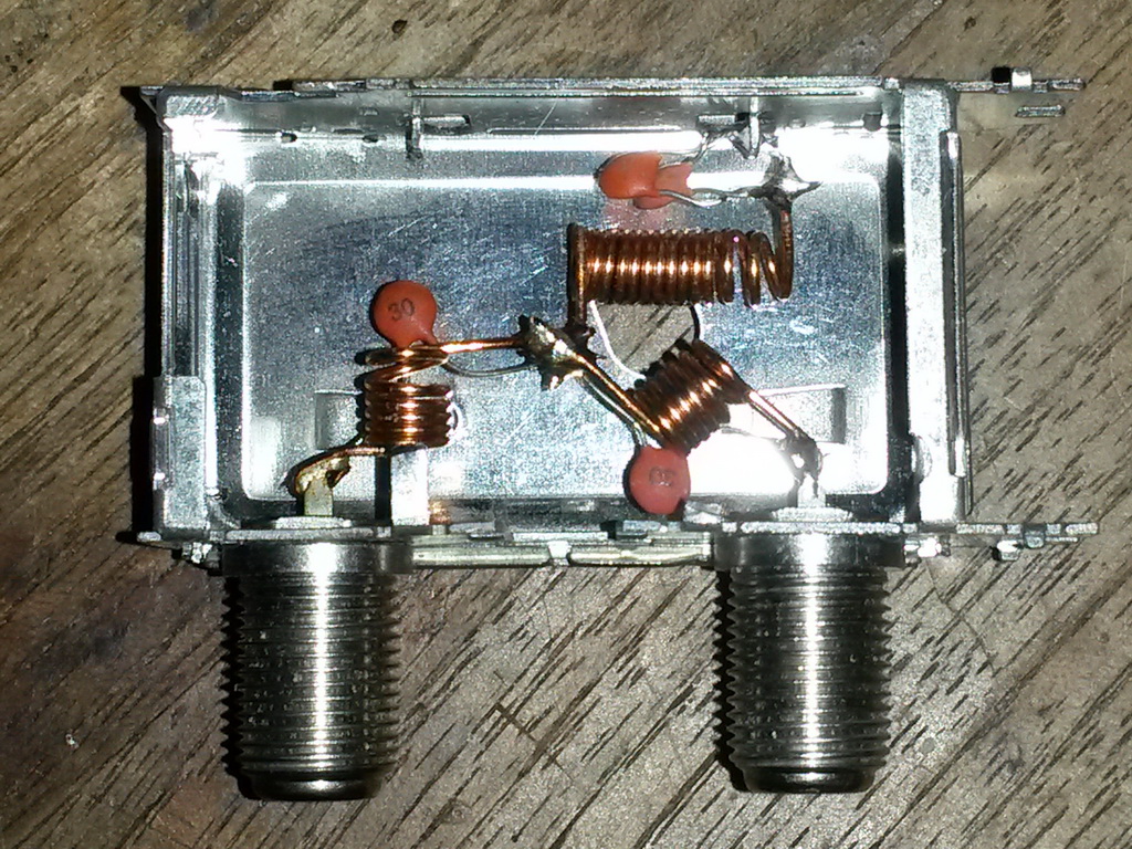

Do you happen to know what is inside an HLSJ?
Inside is a low pass filter and a high pass filter, just as there is inside a UVSJ, but for different frequencies. The general term for these filters is a diplexer. All UVSJs are diplexers, but not all diplexers are UVSJs.

Thanks for the information. I looked inside the HLSJ I got and the component values are more consistent with UHF/VHF splitter. I left the low side alone and put a 5 pole chebyshev on the high side. 160 MHz gave me convenient values.
Part Values
Part Chebyshev 0.1 DB
L1 0.048 uH
L2 0.048 uH
C1 10.19 pF
C2 5.92 pF
C3 10.19 pF

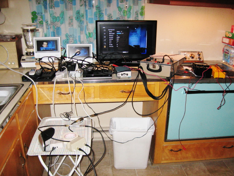

One time I did a test setup with the antenna and preamp connected to a 4-way splitter and then to two converter boxes, two 8-inch monitors, a Sony 22-inch LCD TV, and signal level meter. This was a temporary setup to compare the sensitivity of the tuners using a step attenuator to bring the signals to the digital cliff. The antenna coax was not grounded.
When I touched the coax and the metal strip on the edge of the counter I felt a mild shock. I investigated further and found that what I felt was the sum of the leakage currents from all of those AC operated devices. The leakage current measured about 200 uA; not a dangerous amount but enough to be felt.
I connected a wire only to the grounding pin of a 3-wire plug (no connection to the other pins), connected the other end of the wire to the splitter case, and inserted the plug into a properly wired 3-wire outlet. This connected the coax shield to the house electrical system ground. The leakage current then measured zero.
So, I'm very particular about grounding the coax shield to the house electrical system ground with a grounding block for personal electrical safety AND to reject interference.

I did some checking with my multimeter and there is 60 VAC between my PC case and the LCD TV.
Maybe you have leakage current. You probably don't have a Simpson 229 Leakage Current Tester, but you can build a simple circuit to make tests.

there is 60 VAC between my PC case and the LCD TV. Both are plugged in to different 3 prong outlets. There is no ground wire on either outlet.
You have two 3 prong outlets, and neither one has the socket for the grounding pin of a 3-wire plug connected to ground?
Please make some leakage current tests soon.
