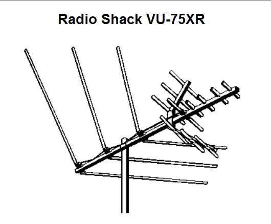

As for the antenna, is there a way to modify the VHF section so it works better on channel 13? I believe 13 inch elements would be a half-wave dipole. The live elements on the antenna are 6, 26, 38, and 48 inches. That's not exact because its cold and dark out but close. It seems to me that with 13 being the lowest channel, I don't need any elements longer than 13 inches.
You don't need to modify the antenna for channel 13. It's as good as it will ever be for 13. If you need more gain for channel 13, you should use an antenna with more gain.
Channel 13 is 210 to 216 MHz; center frequency 213 MHz. A half wave dipole is 5540/freq in MHz, with the answer in inches.

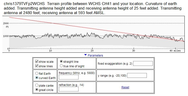

So, you have three issues that are making TV reception difficult.
1. Very strong FM signal interference
2. A very strong TV signal WKAS, that limits your use of a preamp to help you with WCHS ABC.
3. The hill, that makes your desired signals weaker from that direction.
http://forum.tvfool.com/attachment.p...3&d=1459994634

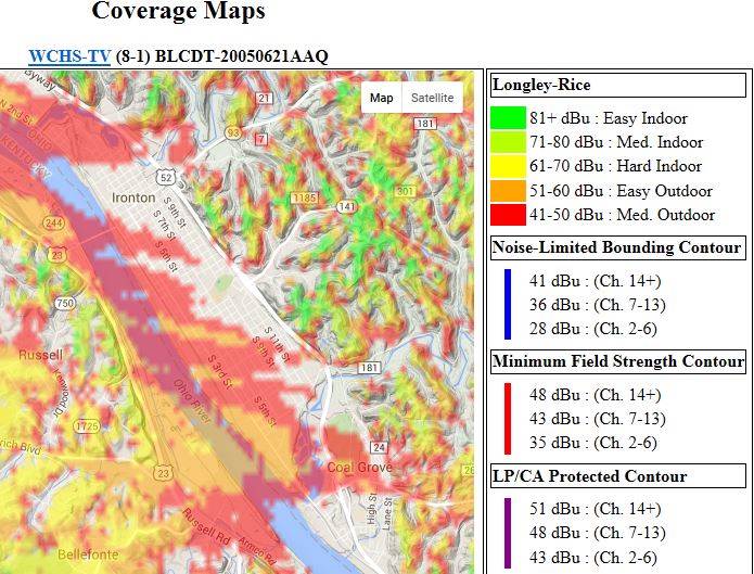

Here is a close up of the WCHS coverage map for your area. Where there is red, the signal is weak. Where there is no color, it is even weaker, which is why WCHS has a NM of -11.1 dB. Any channel with a Noise Margin of less than -10 dB is difficult to receive. If you are able to receive them, you have an excellent antenna system, your tvfool report is wrong, or they have been enhanced by Tropospheric Propagation.
http://forum.tvfool.com/attachment.p...4&d=1459995010

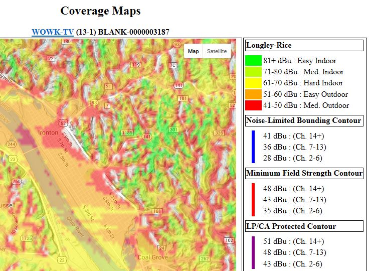

WOWK also has to make it over the hill, but VHF signals can do it better than UHF signals.
The design of the VU75 is of a different type than you're referring to.

I found this diagramon my antenna. It seems to have more gain on higher VHF channels so that's good.

It's a little involved. I'll take you through it for WOWK step-by-step:
http://www.rabbitears.info/
First Section, Web Listings
Type wowk in Find: Call Sign box and click Search which will take you here:
http://www.rabbitears.info/market.ph...&callsign=wowk
Digital TV Market Listing for WOWK
scroll down to WOWK
click on Technical Data and Screencaps in yellow band which will expand the yellow band
click on RabbitEars TV Query which will take you here:
http://www.rabbitears.info/tvq.php?r...ms&facid=23342
RabbitEars TV Query for WOWK
WOWK-TV - HUNTINGTON, WV, US - Main Listing
scroll down to Area: and click on Longley-Rice Coverage Map which will take you here:
http://www.rabbitears.info/contour.p...=2001528&map=Y
Coverage Maps
WOWK-TV (13-1) BLANK-0000003187
Look for Ashland; it is half way out from the center of the circle toward 9 o'clock
zoom in on Ashland
Ironton is NNW of Ashland
Your location is just SW of where 141 meets 52
You will see more signal color in your area because WOWK is stronger than WCHS but there is a dead zone around S 10th and Adams St near the Holiday Inn
http://forum.tvfool.com/attachment.p...6&d=1460052307
Yes, the pattern shows more gain on VHF-High than on VHF-Low, which agrees with the specs.
