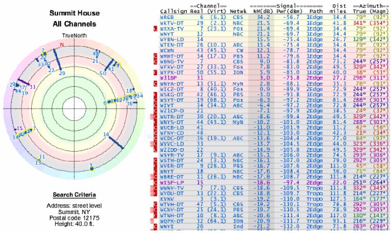

Your tvfool reports are no longer on the server; please redo your report using coordinates for best accuracy. You can find your coordinates by moving the cursor on the interactive map. The coordinates will change below the map as you move the cursor by drag and drop.
I found an image of your old report, but it is not as useful as an active link to a report. Is it accurate?
Here is a link to another report I did today from an estimate of your location:
http://www.tvfool.com/?option=com_wr...dfafe6524b49ec
Is it accurate?
or is this one better:
http://www.tvfool.com/?option=com_wr...dfaf5556ae6a08

It isn't, use the interactive maps tool to accurately place the marker on your rooftop, set your height, then generate a new plot.
This happens all the time, Google's geo-coding of addresses has serious gaps in its accuracy.

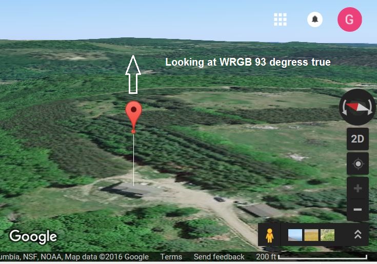

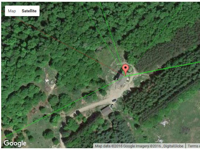

What I'm trying to find out is, if your antenna location is in the clear in a open area or surrounded by trees. That might give us a clue about you reception problem. At this point, we really don't know the cause.
What I really would like to see is a satellite view of the house with green signal lines done with the tvfool interactive map browser.

I read through your thread again:
Originally Posted by agmccall View Post
The image you posted was close. My house is actually the one hidden by the (+) sign in the top left of the image.
Is this it?
Here is a report based on the coordinates for the image above at 25 ft:
http://www.tvfool.com/?option=com_wr...dfaf02be2e50c8
40 ft
http://www.tvfool.com/?option=com_wr...dfafc5ff98ab84
