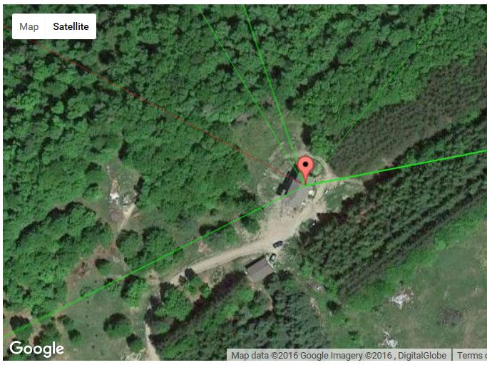

rabbit73 13-Sep-2015 7:31 PM
2 Attachment(s)
Hello, Al:

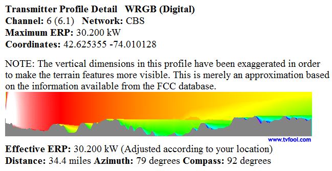

The Winegard HD7084P antenna suggested by ADTech and Tower Guy is still the best for you, because you need WRGB on real channel 6.
http://www.solidsignal.com/pview.asp?p=hd7084

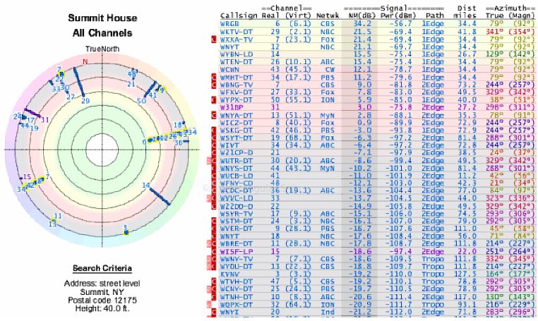

You can see the networks available to your zip by clicking on the callsigns here:
And the aim is still 79 degrees true, 92 degrees magnetic by a pocket compass, not an iPhone compass. You can also use the green signal lines shown on the TVFOOL interactive map browser, after you move the cursor to the antenna location, to pick a landmark for aiming.
for example:
http://forum.tvfool.com/attachment.p...6&d=1442171574
The "new" Channel Master 7777 is probably still the best preamp for you. It is easily overloaded by strong signals, but you don't have any. Based on an estimate of your location, I also don't see any strong FM signals that would interfere with the reception of channel 6. The 7777 has an internal FM filter that is set to IN by default, but I'm not certain if that will affect channel 6 or not. See attachment 2. You can do your own FMFOOL report here:
http://www.fmfool.com/
Alternate preamps are the CM 7778 with a little less gain but more resistance to overload, and the RCA TVPRAMP1R which is less expensive but has a history of quality control problems.
I will be purchasing and installing antenna in the next month and a half. I will be renting a lift to install a chimney on one side of the house and thought that would be a good time to install the antenna.

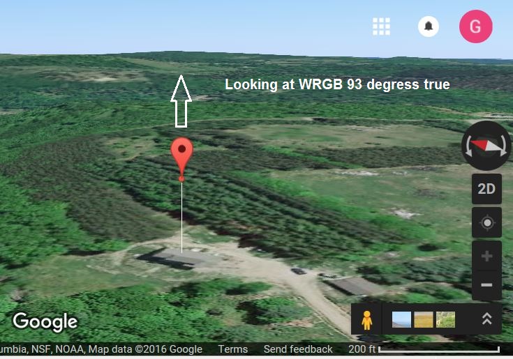

I understand your problem, but I don't think it's a good idea to mount an antenna on the chimney until the mortar has reached full strength. And I question the wisdom of mounting a large antenna on the chimney even after the mortar has reached full strength.
The install of the antenna for me will be a one shot deal as I will not be able to get on the roof with ladders I need the lift. and at the price of rentals I can only do this once.
Because of so many unknown factors, like the trees, there is no way I can guarantee immediate success; some experimentation might be required.
http://forum.tvfool.com/attachment.p...9&d=1441917363
The house is off-grid and the power system (Batteries and inverter system) is in garage and ground rods are in place.
Inverters can cause interference to TV reception. Sine wave inverters cause less interference than modified sine wave (which really should be called modified square wave) inverters. The interference can be conducted, radiated, or both. Some off-grid systems have a small sine wave inverter like the Exeltech XP125 for the TV and move the antenna away from the house as much as possible. (I read Home Power Magazine.)
agmccall 13-Sep-2015 11:19 PM
thanks Rabbit for your response.
The antenna will not be on the same side of the house, I should have been more clear about that.
As for the preamp suggested. Can that be put in the basement or does it have to mounted to the mast with the antenna?
I have coax run in the house where I want my TV's and they all come together in the basement. Should I use the channel Master CM3414 4-Port Distribution Amplifier for Cable and Antenna Signal with it as a splitter or should I get an unamplified splitter.

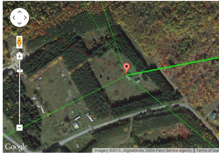

The image you posted was close. My house is actually the one hidde by the (+) sign in the top left of the image.
Thanks again
al
rabbit73 13-Sep-2015 11:20 PM
4 Attachment(s)

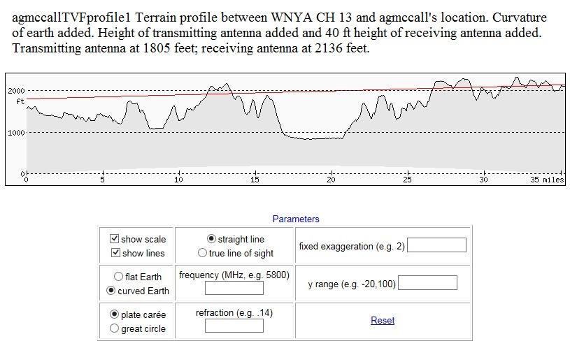

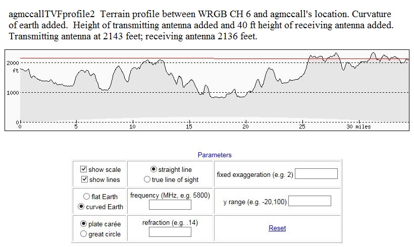

Besides the interference from the trees, you also have terrain interference for the signals on their way to your location:
Your weakest signal (the transmitter is at the left end; your location at the right):
http://forum.tvfool.com/attachment.p...8&d=1442186387
http://forum.tvfool.com/attachment.p...9&d=1442186404
Your strongest signal:
http://forum.tvfool.com/attachment.p...0&d=1442186421
http://forum.tvfool.com/attachment.p...2&d=1442187582
VHF signals can make it over the peaks better than UHF signals, by refraction.
rabbit73 13-Sep-2015 11:56 PM
The closer it is to the antenna, the better. The signals should be amplified before they encounter the coax loss. The amp cannot recreate a weak signal once it is lost. Also, the total system noise figure is best improved by the preamp when close to the antenna, which benefits the weakest signals. However, you are welcome to try it down below; I understand your desire to avoid having to go up there any more than necessary. That is not the best location because you would lose half the signal (3 dB). The attenuation factor for RG6 is about 6 dB per 100 feet for UHF.
I suggest the preamp near the antenna and one TV below for a test. Then, add a passive 4-way splitter for more TVs. If there isn't enough signal, replace the splitter with a 3414.
DO NOT combine cable and OTA signals. It might cause cable signals to be radiated by your antenna system, which is illegal. The FCC has strict limits for radiation by cable systems because some channels are in the aircraft band.
https://www.google.com/?gws_rd=ssl#q...+system+egress
https://www.fcc.gov/guides/cable-signal-leakage
The image you posted was close. My house is actually the one hidden by the (+) sign in the top left of the image.
Thanks for telling me; I rarely get to find out how close my guess was because this site tries to protect the identity of users.
