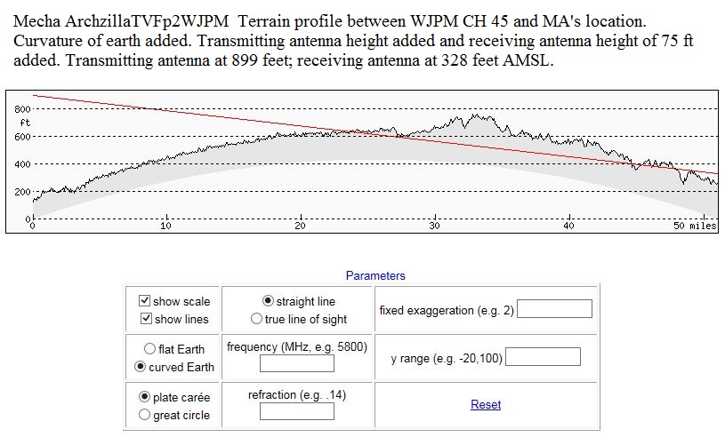

The curvature of the earth blocks your signals from the north and east. Stick with the local signals from the SW.

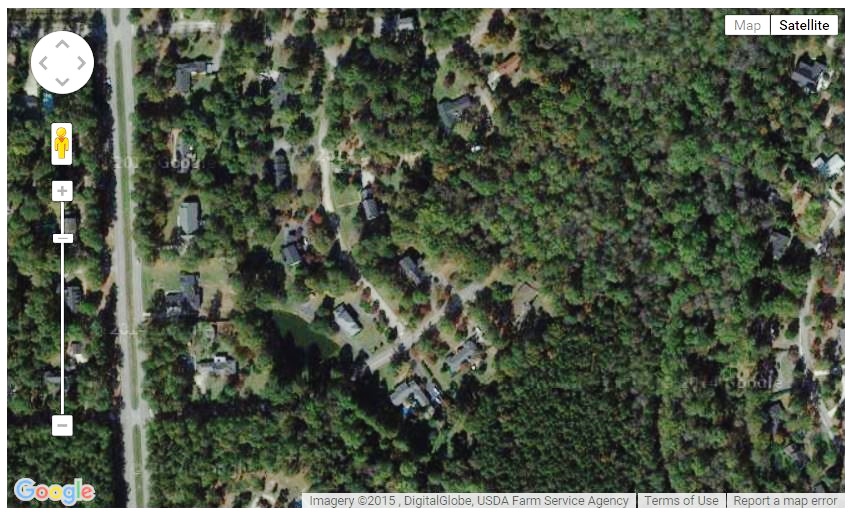

Unless you can get your antenna above the trees, you will have trouble even with your local signals. See attachment 1.

Coverage map for WJPM with antenna at 75 feet. You can see there isn't much signal left by the time it reaches your location:
And you can see how the curvature of the earth causes a problem for the WJPM signal:
