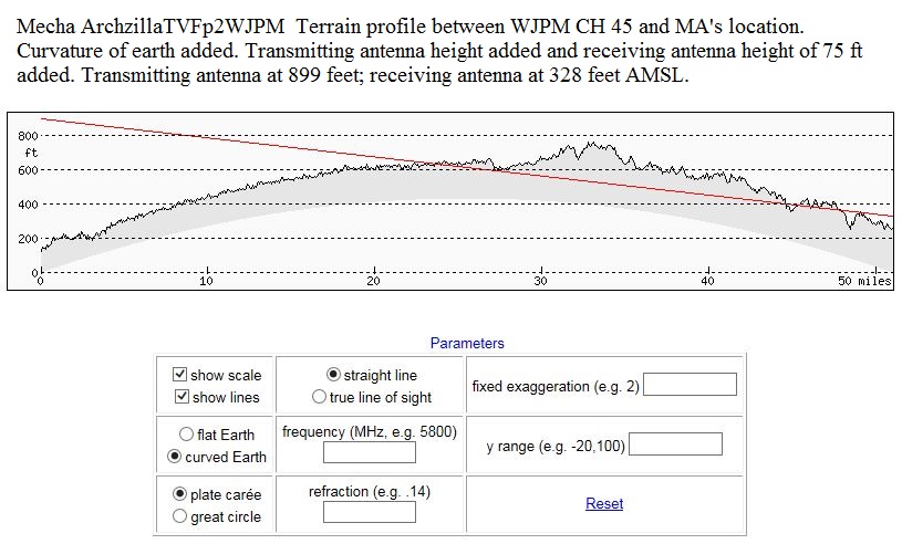

rabbit73 16-Oct-2015 11:35 PM
2 Attachment(s)
Coverage map for WJPM with antenna at 75 feet. You can see there isn't much signal left by the time it reaches your location:
http://forum.tvfool.com/attachment.p...3&d=1445038540
And you can see how the curvature of the earth causes a problem for the WJPM signal:
http://forum.tvfool.com/attachment.p...4&d=1445039545

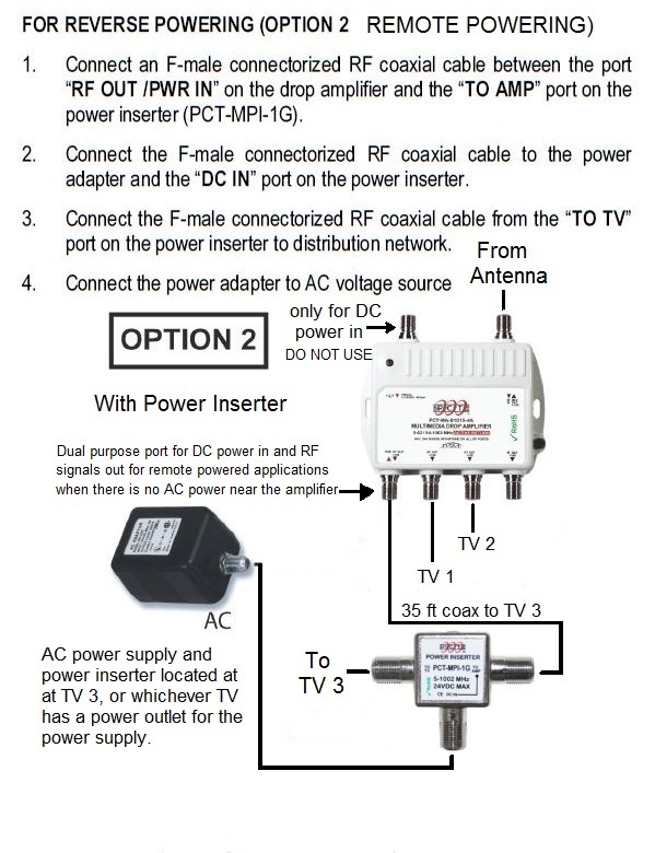

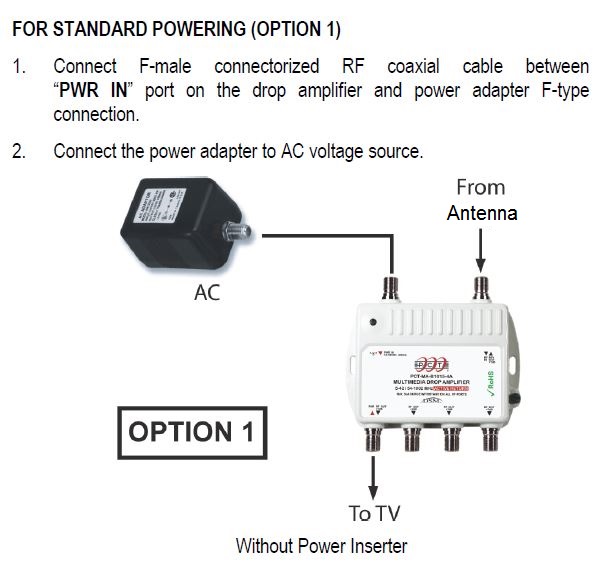

rabbit73 31-Oct-2015 7:21 PM
Power options for Channel Master 3414 Distribution Amp:
http://forum.tvfool.com/attachment.p...5&d=1436753309
________________________________________________________________________
http://forum.tvfool.com/attachment.p...6&d=1436753324
http://forum.tvfool.com/attachment.p...7&d=1436753605
Mecha Archzilla 1-Nov-2015 2:02 AM
Thanks for that. Cancelled the order and got the CM-3418
rabbit73 1-Nov-2015 8:04 PM
Why did you cancel the 3414 order?
Mecha Archzilla 1-Nov-2015 8:38 PM
I was able to run the cable to the other room upstairs,so when I saw the picture I realized I needed another output.
