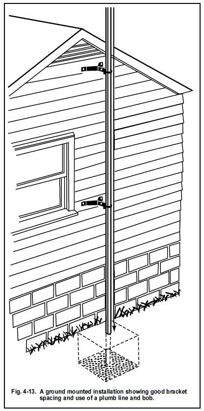

How about a ground mounted mast. It would be more secure than an eave mount, but less expensive than a tower.
http://manuals.solidsignal.com/AntInstallGuide.pdf
page 12

Thank you for the documentation rabbit73.
How high can the mast be on a ground mount (if I missed that in the PDF I apologize)? I've attached a picture of the side of my house. I was thinking that a ground mount could be closer to the actual entry point to shorten the coax run. The gas line may be a problem as I currently do not know where the utility comes in from. The biggest concern of mine would be mounting that close to the electrical lines coming to the house and whether that is safe or not.
If you look in the distance you can see the tower my neighbor may or may not be willing to part with for free.

Is a ground mount a way to install an antenna without having to get on your roof? I climbed up there to test out how comfortable I was. Yeah, not happening.
Irata is offline   Reply With Quote
Old 10-Oct-2015, 8:23 PM   #34
Yes, you can put it where you were going to put your original antenna.

Cool. If I was using my deck as a base it's about 15 feet to the peak. Figuring a need to having the mast taller than the house would you use maybe a 25' telescoping mast?
Old 11-Oct-2015, 5:08 PM   #36
If the top of the mast is 5 feet above the peak, and the joint at the bottom of the top section is below the bracket at the peak, that would be OK. If the top of the mast is 10 feet above the peak, it would depend upon where the joint at the bottom of the top section is located. If the joint at the bottom of the top section is above the peak, then the mast would need guy wires, which you probably don't want to mess with.
