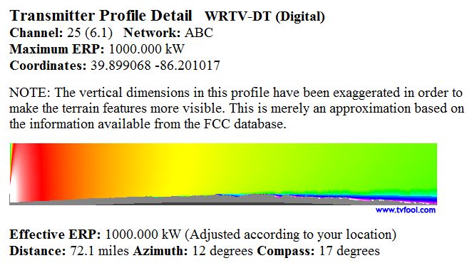

rickbb 28-Aug-2015 6:35 PM
Picking the ABC from 70 miles to show to the profile shows you down in a RF shadow. Not looking good to get that channel. Might be why your neighbors have 30 to 40 towers.
WRTV-DT (Digital)
Channel: 25 (6.1)
Network: ABC
Maximum ERP: 1000.000 kW
Coordinates: 39.899068 -86.201017
https://www.tvfool.com/modeling/tmp/...RE-WRTV-DT.png
NOTE: The vertical dimensions in this profile have been exaggerated in order to make the terrain features more visible. This is merely an approximation based on the information available from the FCC database.
WRTV-DT
Effective ERP: 1000.000 kW (Adjusted according to your location)
Distance: 72.1 miles Azimuth: 12 degrees Compass: 17 degrees
Irata 28-Aug-2015 6:53 PM

Sorry to be such a noob with all of this but can you expand on what you mean? And maybe how to interpret the image on the details page?
rabbit73 28-Aug-2015 7:41 PM
3 Attachment(s)
I'll try.

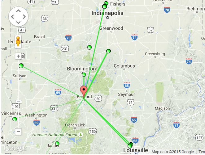

Here is the map:
http://forum.tvfool.com/attachment.p...1&d=1440790881
If you click on a callsign in your tvfool report you will see the profile. The transmitter is at the left end and your location is at the right.
http://forum.tvfool.com/attachment.p...2&d=1440791231
The black arc that you see at the bottom of the image is the curvature of the earth, which starts to interfere with the signal at about 70 miles.
The color code for the image is here:
http://www.tvfool.com/index.php?opti...id=15&Itemid=1
In very rough terms, the colors can be broken down as follows (not related to Antennaweb):
- White is extremely strong. Beware of signal overload on amps.
- Red-yellow-green are all quite strong. You can expect reasonable coverage with an indoor antenna.
- Cyan is where it's advisable to move the antenna up to the second floor or attic.
- Blue is where it's probably necessary to install a good antenna on the roof.
- Purple is quite weak and you really have to work at it for any chance of reception.
Here is the coverage map for WRTV ABC. You can see that the signal is pretty weak by the time it gets to your location. The color code is the same.
http://forum.tvfool.com/attachment.p...3&d=1440791858

Thank you very much for explaining that. I missed it on the site. This looks like I'd have to install an antenna tower for my best shot and cross my fingers I could pick up the signals.

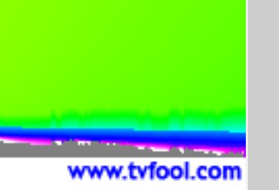

You are welcome. The fact that you were able to get some Louisville stations is promising. WHAS ABC real channel 11 from there could be received with better quality using a different antenna and a preamp. The Amazon antenna probably isn't very good for VHF-High channels 7-13. Unfortunately, ION is in a different direction.
Here is a close-up of the tvfool profile at your location that shows the colors better:
http://forum.tvfool.com/attachment.p...4&d=1440805432

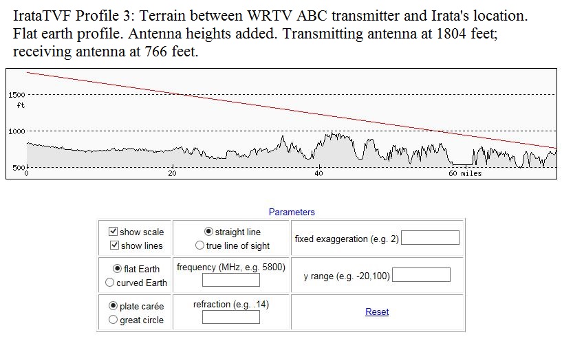

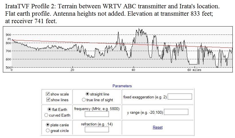

Another way to demonstrate the Indianapolis problem is to use elevation profiles:
http://forum.tvfool.com/attachment.p...5&d=1440805752
adding the antenna heights:
http://forum.tvfool.com/attachment.p...6&d=1440805780

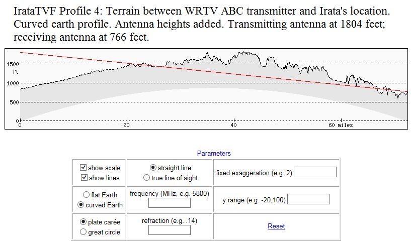

but the earth isn't flat:
http://forum.tvfool.com/attachment.p...7&d=1440805803

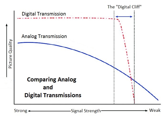

The Indy channels were analog then. You could watch them when they were very weak if you could tolerate a little snow. With digital signals it's all or nothing because of the "Digital Cliff," as ADTech mentioned.
http://forum.tvfool.com/attachment.p...8&d=1440812083

That sounds like a big improvement to me.
I'm not sure which way is north after looking at the photos. Which direction does the side of the house in the third photo face? Without knowing that, my answer is if the present location isn't affected, then the planned location will not be affected.
Ah, yes: I see towers in photo 2.
http://forum.tvfool.com/attachment.p...1&d=1441550522
The preamp is a RCA TVPRAMP1R. Relatively inexpensive so I figured I would experiment a little. I impulse buy. I have it mounted about 6 inches under the antenna.
About an hour or so later most of the Indy stations dropped off. :( Signal still good with the others though. At one point I had, for a few minutes, solid reception of channel 21 out of Fort Wayne which is 100+ miles away. That was weird.
That's the back of the house. It faces south.
I don't think either of those houses use those antennas.
I talked to the lady across the street with the antenna tower(not pictured). It's a bit shorter but only installed a few years back. Said it was never used and told me I could have it if I could get it removed safely.
