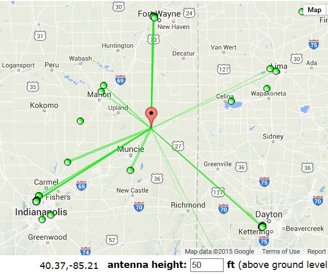

I'm about to cut the cord in the next few weeks and need help on what kind of setup I should have.
http://www.tvfool.com/?option=com_wr...8e03230d0425a8
Just for reference, the stations that are almost perfectly due north are mostly from Fort Wayne, Indiana. The stations in the southwest quadrant are a mix of a couple of nearby cities (in the green) and then Indianapolis in the yellow/red. In the southeastern quadrant, in the red, are stations from Dayton.

So the questions are: A.) What kind of pre-amp or other equipment will I need considering the length of cable? B.) Since the antenna is multi-directional, and if I point the DB8 toward Indianapolis, will it be possible for me to receive Dayton stations as well? I'm thinking I should be able to pick up, at least, the Fort Wayne stations as well from the back of the antenna, since I already do indoors.

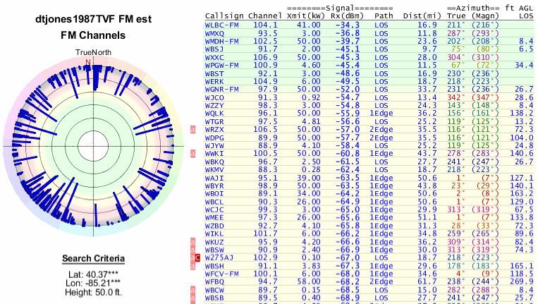

I wanted to see if there were any strong FM signals that would interfere with TV reception. I did an FMFOOL report based on an estimated location that puts you SW of the center of Dunkirk near a school. I don't see any problem that couldn't be handled by an FM trap, that many preamps have. See attachment 2.

Old 31-Jul-2015, 7:59 PM   #3
No. At nearly a right angle to the antenna's boresight, it's almost as blind as a bat by design. In antenna-speak, it's called a "null". The opposite of a null,a peak, is called a "lobe" with the major lobe being straight ahead. On a standard DB8 (not 'e'), the front reception lobe is most sensitive straight ahead out to +/- 15 to 25° on either side. Reception then drops off rapidly as one goes further off towards the side left or right.
