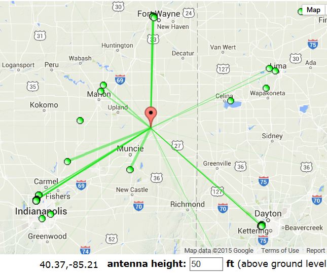

Hi all,
I'm about to cut the cord in the next few weeks and need help on what kind of setup I should have.
http://www.tvfool.com/?option=com_wr...8e03230d0425a8
Just for reference, the stations that are almost perfectly due north are mostly from Fort Wayne, Indiana. The stations in the southwest quadrant are a mix of a couple of nearby cities (in the green) and then Indianapolis in the yellow/red. In the southeastern quadrant, in the red, are stations from Dayton.
I have an Antenna's Direct DB8 antenna, that I test indoors and it seems to be pretty impressive. I get stations from Fort Wayne and Indy (excluding the VHF channels of course.) If I go over to an other side of the house and face the antenna at a Window I can get some Dayton stations at night too. My primary goal is to get the major stations from Indianapolis & Fort Wayne, as well as virtual channel 23 and 49. Those come in with relatively no effort.
The antenna will be going up approximately 50 feet up. Where I live, there is already a Yagi style VHF antenna up there but it is not hooked up. I'd like to be able to use it to pick up Virtual channels 8 & 13. People in this community are able to receive those channels from similar style VHF antennas that I have.
As far as the run, I live in a house that was converted to an apartment and I live upstairs. The coax cable will have probably around 100 feet to travel (down from the antenna, will ground it, and then will have it come backup half way so it can go around the structure to where it will connect with the TVs. We have Dish Network currently and two TVs hooked up (it's one receiver that goes to two TVs.) I can't tell but I think there is splitter from the Dish before it gets into our house (unless they are hooked directly from the dish, but then I can just put them into a splitter) so we plan to hook the antenna into that. The amount of cable from the splitters to the TV will vary. I'm estimating one to be about 30 feet to one TV and another about 15-20 feet to another.
So the questions are: A.) What kind of pre-amp or other equipment will I need considering the length of cable? B.) Since the antenna is multi-directional, and if I point the DB8 toward Indianapolis, will it be possible for me to receive Dayton stations as well? I'm thinking I should be able to pick up, at least, the Fort Wayne stations as well from the back of the antenna, since I already do indoors.
Just any general advice or recommendations would be greatly appreciated!
