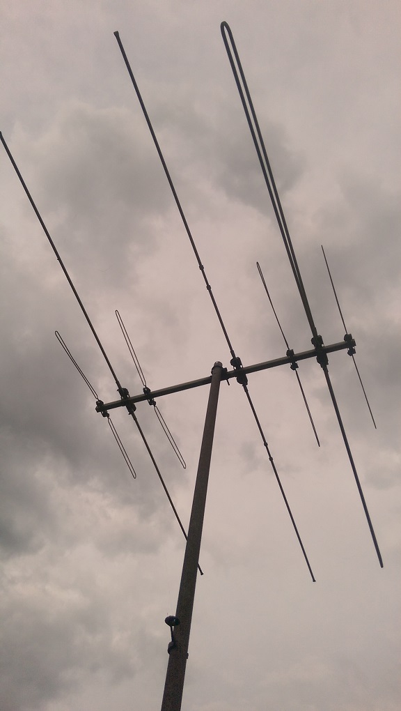

I have an old outdoor antenna that I don't know if it's going to work. I only neeed the channels within 30 miles north and south of my house. The antenna is mounted about 30 feet in the air.

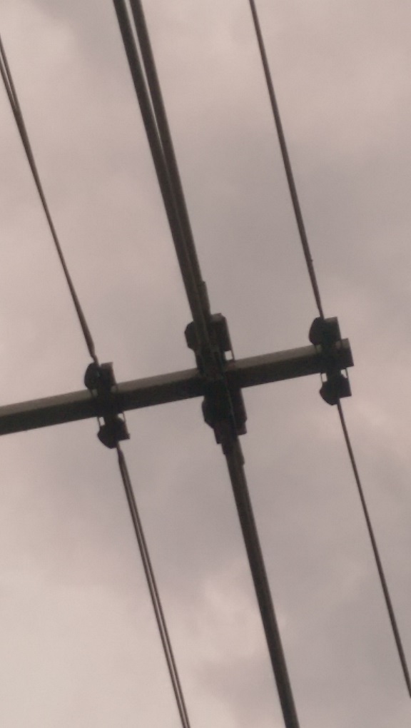

I know I need a balun, but where do I connect it to on the antenna.

Interesting antenna. Looks like it is for VHF real channels 2-13. Most of your channels are UHF with the exception of WKRC on CH 12. You would need something like an RCA ANT751 or a Winegard HD7694P, no amp.

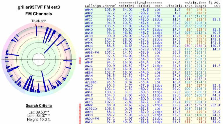

You have some very strong FM signals that might cause interference. I don't have your exact address, so I used your short coordinates to make an FMFOOL report. Insert an FM trap, or 2 in series.

You would probably connect the balun to the center of one of the long elements (maybe the middle one), where there should be 2 wing nuts. I would need a closeup to tell for certain.

Even if your antenna doesn't look like it's the right one for your signals, you should try it first if you can get to it easily.

Am I to assume that the FM signals you mentioned would interfere with my TV signal, and that there is some type of device that would be installed to filter them out?
That is correct. They are so strong that they would most likely interfere. The device is called an FM trap or FM filter. There are 3 brands that I suggested I my previous post, MCM, Radio Shack, and Antennas Direct. You will probably need two in series to make your FM signals weak enough to avoid interference.
