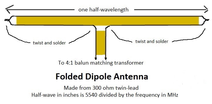

For CTV the only one that is strong enough is CJOH-TV on real channel 6, which is so strong that he could probably receive it with an indoor rabbit ears antenna or folded dipole antenna.
5540/85 = 65 inches, See Attachment
