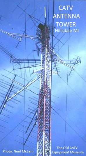

He would like to get all of the 'major' channels here in Canada but DOES NOT want a rotor.
His expectations are not realistic. It would require a CATV tower. Where will the antennas be located, inside or outside?
http://forum.tvfool.com/attachment.p...1&d=1433184279
I am always amazed when someone wants a simple system that duplicates what a CATV system does with multiple antennas, amplifiers, and modulators costing thousands of dollars. You will need to cut back on your expectations and settle for improving one direction or be prepared to spend a lot of time and money building a system that does what you want.
