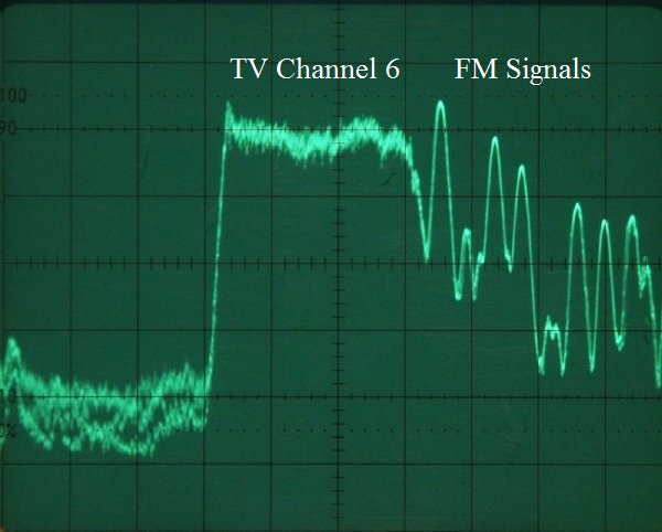

FM signals, which are between TV channel 6 and TV channel 7, can interfere with the reception of TV signals in several ways. They can cause fundamental overload of tuners and preamps in the VHF band, and even in the UHF band if they are strong enough. The second harmonic of an FM signal can interfere with a VHF-High (7-13) TV signal. Very strong FM signals at around 88 MHz can cause adjacent channel interference to TV channel 6.

Strong FM signals at the low end of the FM band (88 MHz) can cause co-channel interference to CH 6 TV signals that are just below 88 MHz.
