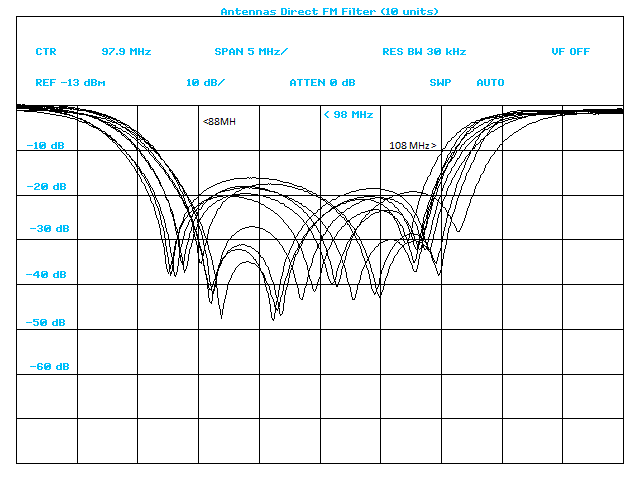

Different FM filters have different characteristics. You have strong FM signals near 88 and 108 MHz, so neither the Antennas Direct or the Radio Shack would do, unless you put one of each in series. See Attachment No. 3.

I've found that there can be considerable variability between individual filters from the same shipment since they're hand assembled.
I tested a batch of 10 filters back in late 2010 from an incoming shipment that demonstrates the variability. From that batch, one filter only attenuated 108 MHz by 10 dB, another by 35 dB. The majority were between 15 and 22 or so.
http://forum.tvfool.com/attachment.p...1&d=1433353119

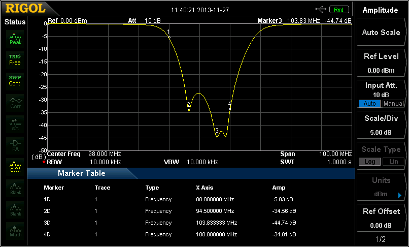

Here's a single RS 15-0024 that I tested back in Nov 2013. It's the only one I tested.
http://forum.tvfool.com/attachment.p...1&d=1433352436

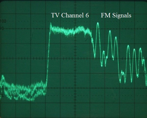

FM signals, which are between TV channel 6 and TV channel 7, can interfere with the reception of TV signals in several ways. They can cause fundamental overload of tuners and preamps in the VHF band, and even in the UHF band if they are strong enough. The second harmonic of an FM signal can interfere with a VHF-High (7-13) TV signal. Very strong FM signals at around 88 MHz can cause adjacent channel interference to TV channel 6.

Strong FM signals at the low end of the FM band (88 MHz) can cause co-channel interference to CH 6 TV signals that are just below 88 MHz.
http://forum.tvfool.com/attachment.p...1&d=1433469297
