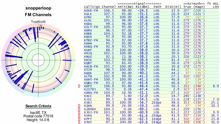

This is what your FM signals look like. They are not real strong, but an FM trap might help.
A separate more directional VHF antenna coupled with your 7694 just for UHF with a UVSJ might help. The idea is to use a VHF antenna that has more gain not just for the gain but for its increased directivity to improve the SNR of your VHF signals that are almost wiped out by noise from electrical interference.
