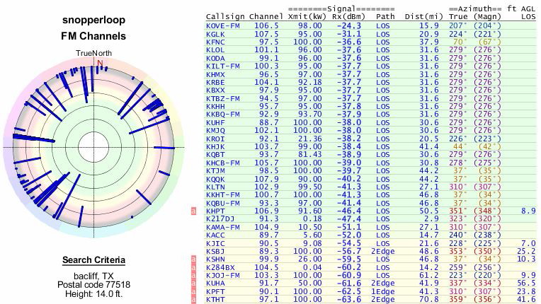

rabbit73 3-Apr-2015 1:23 AM

This is what your FM signals look like. They are not real strong, but an FM trap might help.
http://forum.tvfool.com/attachment.p...1&d=1428020886
