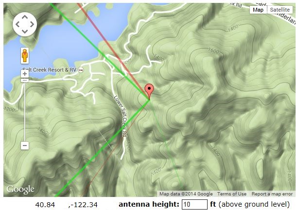

Old 24-Sep-2014, 1:40 AM   #5

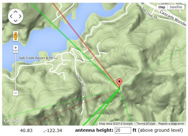

I can't really generate a new report because I need to physically hike up the hill to figure out the coordinates and plan which tree to use as a mast.
I estimated your location and used the tvfool interactive map feature for this report:
http://www.tvfool.com/?option=com_wr...d243c78918b8a1
Pretty close to your original report.
I then moved the teardrop cursor to the top of the hill south of you (20 ft up in the tree) and got this report:
http://www.tvfool.com/?option=com_wr...d2438e744b90c9
The signals look much better.
For your protection, I erased some of the coordinate numbers just the way tvfool does in a report that uses coordinates.
10 ft up:
http://www.tvfool.com/?option=com_wr...d243424a5cb5be
5 ft up (if nothing is in the way in front of it):
http://www.tvfool.com/?option=com_wr...d2432a53ca1d25

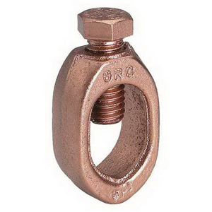

So if I understand correctly, grounding block/rods at the base of the tree, where the coax enters the house, and messenger cable if I use it. I played with the coordinates, and it appears like I can get a similar decent signal at a different point on the hill at 10' that is closer to my house. I'm rethinking using conduit and going with direct bury since all the labor is on me, and I'm trying to reduce the amount of time I play in the forest to keep my wife from wanting to kill me. I have some more unanswered questions:
1. The guy at Lowes said a piece of rebar would work just fine as a ground rod. Is he an idiot?
It will work if the connection is good. Electricians use an 8 ft grounding rod to meet NEC specs; a 4 ft rod is too short.

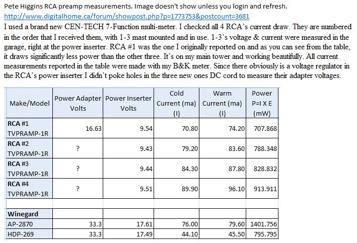

3. The instructions for the preamp state the indoor power supply cant be more than 150' away, yet mine will greatly exceed that. Is that ok, or is that why I'm going with the solid copper core?
The rule-of-thumb is that the solid copper core gives you twice the distance as copper coated steel. What it boils down to is this: is there enough voltage at the preamp for proper operation? Many of the new preamps use more current (300 mA, meaning more voltage drop) than the older preamps, like the original CM7777 (125 mA). My original CM7777 is very tolerant of reduced voltage. Pete Higgins has made some tests of his RCA preamps for current and voltage, attachment #4. He has a thread on this forum about it:
RCA TVPRAMP1R Amplifier
http://forum.tvfool.com/showthread.php?t=13530

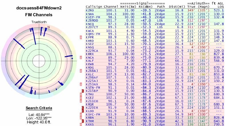

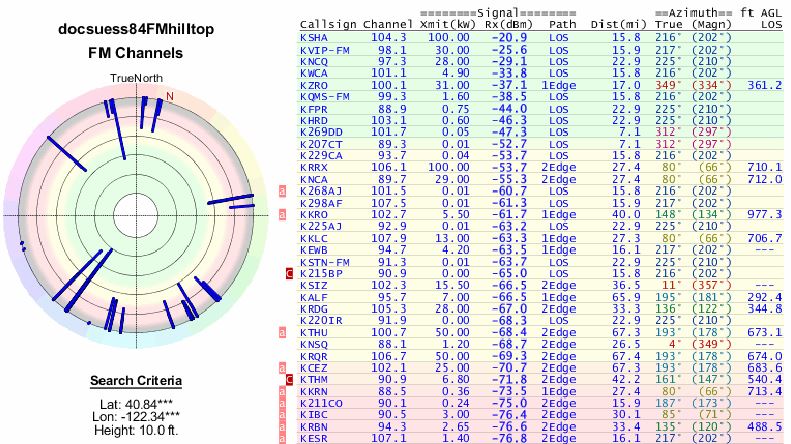

5. On the note of FM, I read that if I join two antennas together pointed in different directions, I should turn the FM switch off of the preamp to avoid reduced performance. How would I go about incorporating FM reception into my set-up in light of that?
That's not a good idea for your situation. Keep the FM separate for simplicity. However, Calaveras made it work as you can see in his diagram, but he is a lot smarter than I am. Attachment #2 is your FM signals down the hill; attachment #3 is your FM signals up the hill. KSHA, 104.3, is very strong.

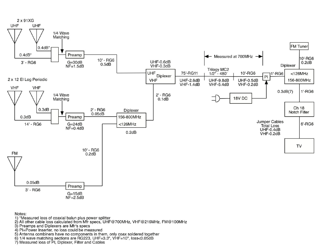

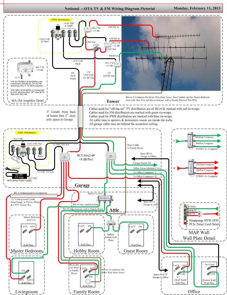

I find your intelligent questions about your installation almost over my head. I have a fairly good grasp of the theory, but I don't have much practical experience with an installation like yours that requires some custom solutions for your problems:
I don't know about the regulations in your area for an antenna installation. Some towns require an electrical inspector to give an OK for an installation; others don't seem to care. I would hesitate about asking your inspector about your installation until you find out what kind of person he is. Ask a local electrician about the inspector when he helps you with your ground connections to your electrical system. The dish guy would also know about your inspector and if any inspections are required. There is a device called an OTA/satellite diplexer that allows the same coax to be used for both signals. It usually allows DC power for the dish to get thru, but I don't think it will power your preamp.
http://www.hollandelectronics.com/ca...-Diplexers.pdf
A long run of RG6 coax has a signal attenuation of about 6 dB per 100 ft for UHF. RG11 is only a little better at 5 dB, and 1/2" 75 ohm hardline about 2.5 dB. The question is whether the reduced attenuation of the larger coax is worth the expense. The other consideration is how much the coax will reduce the voltage to the preamp, if you use one. Pete's chart for the RCA preamp shows the output voltage of the regulator, but it doesn't tell us how much the voltage can be reduced and still allow proper operation. In his earlier installation he used a separate voltage feed wire to the top of his tower and added a voltage regulator near the preamp. Calaveras used a custom power supply for his power injector that delivered enough voltage to his preamp on the upper end of his long coax.
Before you spend a lot of money, I suggest that you consult a senior level guru like Pete Higgins or Calaveras (they live in California) about your installation. Both of them have towers, long runs of coax, and have integrated FM into their antenna systems. You can see how they have solved their problems in the diagrams in the attachments. You can send them a PM; Pete Higgins often comes to this forum, and Calaveras is often found here:

Old 1-Oct-2014, 12:24 AM   #15
I tried some tvfool reports using the coordinates for your new hill location. The signals are not as good as the first hill location in post #5 at 10 ft, but still usable:
10 ft:
http://www.tvfool.com/?option=com_wr...d2438143458058
CH7 NM 42.3 dB 1Edge
CH9 NM 36.2 dB 1Edge
CH38.1 NM -29.3 1Edge NG
20 ft:
http://www.tvfool.com/?option=com_wr...d243a64bf5b603
CH7 NM 47.6 dB LOS
CH9 NM 43.3 dB LOS
CH38.1 NM -11.8 1Edge maybe with preamp and separate UHF antenna
30 ft:
http://www.tvfool.com/?option=com_wr...d243f318247686
CH7 NM 50.1 dB LOS
CH9 NM 45.4 dB LOS
CH38.1 NM +19.2 dB LOS looking better but still with preamp and separate UHF antenna
10 ft would probably give you 7 and 9, but not 38.
At 20 ft 7 and 9 are looking good; 38 might be possible with a separate high gain UHF antenna.
At 30 ft all are LOS and looking excellent.
If you can get your antenna high enough at the new hill site you have a good chance for at least 7 and 9 without a preamp. One factor in your favor is that the coax loss for VHF-high is much less than for UHF; about 2 dB per 100 ft VS 6 dB per 100 ft of RG6.
400 ft of RG 6 would give a loss of 8 dB which you would subtract from the NM figures for 7 and 9.
Antenna gain can be added to the NM figure and the signal pwr figure. You can add the preamp gain to the signal pwr figure, but you can't add the preamp gain to the NM figure without subtracting the preamp NF because the preamp NF reduces the SNR of the signal.
Andy S. Lee, the creator of this forum, has a good post about NM here:
http://www.avsforum.com/forum/25-hdt...l#post15700679
You can make Andy's diagrams larger by clicking on the 2nd set at the end of his post. They were attachments before AVS switched to a new (UGH!) software and added so many ads that they squeezed the posts to a narrow width, giving the impression that ads are more important than the posts. Click again on each diagram if you see a plus sign on your cursor, which will make the diagrams even larger.

The wire goes between the rod and the V notch, not under the end of the screw.
The coax should be grounded down at the house to a grounding block to drain any static buildup. Since the coax will be connected to AC operated equipment in the house, grounding the coax will also protect you from shock if any of the equipment becomes defective and from normal leakage current that exists on all AC operated equipment.
