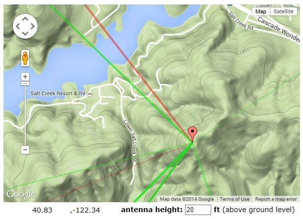

I can't really generate a new report because I need to physically hike up the hill to figure out the coordinates and plan which tree to use as a mast.
I estimated your location and used the tvfool interactive map feature for this report:
http://www.tvfool.com/?option=com_wr...d243c78918b8a1
Pretty close to your original report.
I then moved the teardrop cursor to the top of the hill south of you (20 ft up in the tree) and got this report:
http://www.tvfool.com/?option=com_wr...d2438e744b90c9
The signals look much better.
For your protection, I erased some of the coordinate numbers just the way tvfool does in a report that uses coordinates.
http://forum.tvfool.com/attachment.p...1&d=1411524483

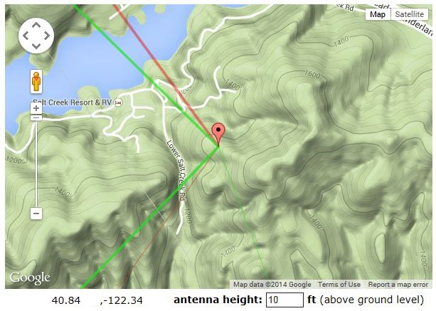

10 ft up:
http://www.tvfool.com/?option=com_wr...d243424a5cb5be
5 ft up (if nothing is in the way in front of it):
http://www.tvfool.com/?option=com_wr...d2432a53ca1d25

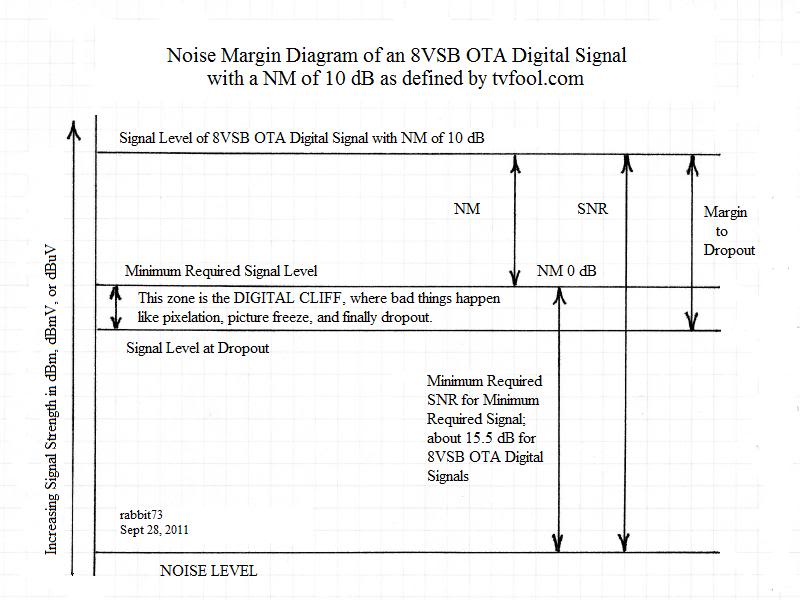

Antenna gain can be added to the NM figure and the signal pwr figure. You can add the preamp gain to the signal pwr figure, but you can't add the preamp gain to the NM figure without subtracting the preamp NF because the preamp NF reduces the SNR of the signal.
http://forum.tvfool.com/attachment.p...1&d=1412127904
Andy S. Lee, the creator of this forum, has a good post about NM here:
http://www.avsforum.com/forum/25-hdt...l#post15700679
You can make Andy's diagrams larger by clicking on the 2nd set at the end of his post. They were attachments before AVS switched to a new (UGH!) software and added so many ads that they squeezed the posts to a narrow width, giving the impression that ads are more important than the posts. Click again on each diagram if you see a plus sign on your cursor, which will make the diagrams even larger.

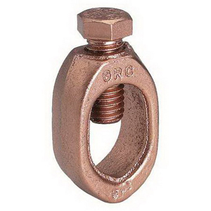

http://forum.tvfool.com/attachment.p...1&d=1412302304
The wire goes between the rod and the V notch, not under the end of the screw.
