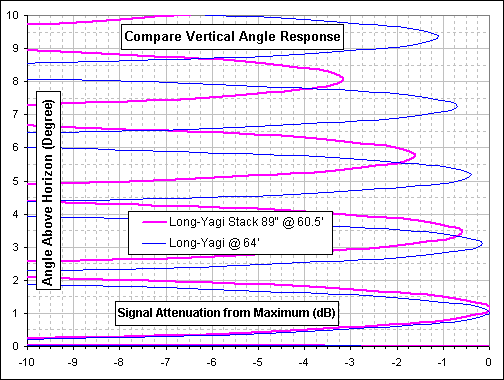

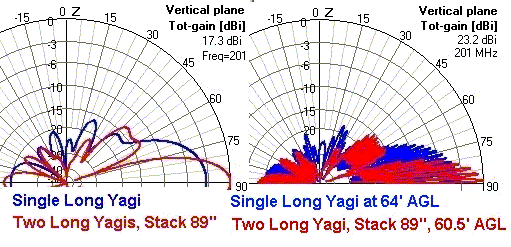

Computer simulations with 4NEC2 software provides for graphing the vertical beam pattern of antennas. The horizon is shown on the 4NEC2 graphs as 90 degrees. The image below shows on the left, the upper half-pattern in free space of a single long-Yagi; overlaid is a stack at 89 inches.
The second pattern, on the right side, shows the response of one long-Yagi at 64 feet that is overlaid with a stack at 60.5 feet (60.5 feet is the average height of the stack). This pattern shows multiple nulls or minimas, these arise from ground reflections being out of phase with the direct signals. The presence of ground also produces additional ~6dB antenna gain at vertical angles where the reflection adds in phase with the direct signal.
It can be seen that the antenna stack has increased gain at lower angles. This could help the problem of frequency selective fade. The rationale is; for both tropospheric scatter (tropo) signals as well as 2-Edge signals (if the nearest edge is relatively far away), the major signals arrive at lower angles. Since the troposphere reaches to ~6 miles in height, tropo can have many paths, with some signals arriving at higher angles. For higher angles, the signal must travel greater distances and may be out of phase with the low-angle & earlier signals. The stacked antennas provide some angle-of-arrival discrimination for elevation angles greater than about 1.2 degrees (88.8 degrees on the graph).

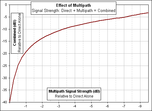

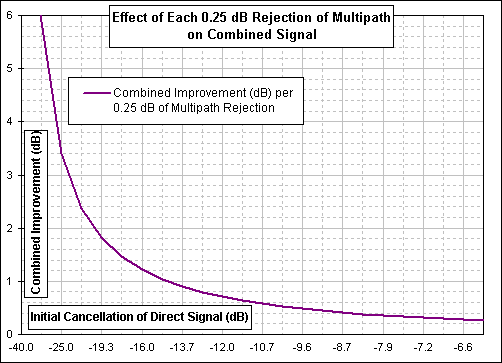

To estimate how much rejection may be required to improve a deep signal fade (null). The sum of two signals can be calculated using vector addition. It can be visualized that the sum two equal vectors at, or near, 180 degrees out of phase with respect to each other, add to near zero.
Suppose the desired, or direct, signal had amplitude of +1 Volt, and a multipath signal had equal or lesser value of amplitude, but was 180 degrees out of phase (-1) with the desired signal.
As examples, to the direct signal add decreasing magnitudes of a multipath signal:
+1 added to –1 = 0
+1 added to –0.95 = 0.05 (26 dB below a Voltage of 1 Volt)
+1 added to –0.90 = 0.10 (20 dB below a Voltage of 1 Volt)
In above, dB=20 x [Log10(Volts)]
Changing the multipath signal magnitude from 0.95 to 0.90 results in a ~6 dB improvement in the combination. In terms of dB rejection relative to desired:
Magnitudes of Multipath and dB Rejection
0.95 = 0.45 dB (relative to desired),
0.90 = 0.92 dB (relative to desired)
Difference = -0.47 dB
A multipath reduction of 0.47 dB, relative to desired signal, improved combined signal ~6 dB (26 dB to 20 dB).
As the amplitude of one of the vectors becomes smaller than the other, then the magnitude of their combination rapidly increases. The image below graphically shows the result of combining two signals arriving; one of them 180 degrees out-of-phase with respect to the other.
In the graph, as an example observe the curve at 25 dB. A 25 dB null can occur if the reflected signal has amplitude that is only ~0.5 dB lower than the direct signal. The greater the difference in amplitudes of the two signals, then the shallower the null will be. For example if the multipath signal is about ~10 dB weaker than the direct signal, then the combination may be reduced about 3 dB.
It can be seen that the deep nulls (say 25 dB) are sensitive to small changes in amplitude of the direct and multipath signals. The image below shows sensitivity to multipath signal changes of 0.25 dB relative to the direct signal.
In the chart immediately above, for an initial ~ 25 dB combined cancellation or null, if one could decrease the multipath signal by 0.25 dB, there could be an improvement in the combined signal of ~3 dB. If the initial combined null depth is ~10 dB, this improvement diminishes to ~0.5 dB improvement for a 0.25 dB multipath amplitude reduction. That is more than a 2 for 1 reduction in destructive interference for every 0.25 dB rejection of the out-of phase (multipath) signals. So, it appears that relatively modest amounts of signal discrimination can result is appreciable improvement for the combined (desired) signal.
In this case, the low angles are of most interest. The image below shows an expanded view of the elevation patterns shown in the first image above. The stacked antennas have increased gain, but in order to compare vertical patterns responses, the single antenna and the stacked antennas are shown with both patterns normalized. For convenience, the vertical angle is shown as degrees above the horizon.
It can be seen that for angles above about 2 degrees, the stack has at least 0.5 dB discrimination compared to the single antenna. On average, higher angle-of-arrival signals above 2 degrees are rapidly decreased due to the narrow elevation response of the stack.

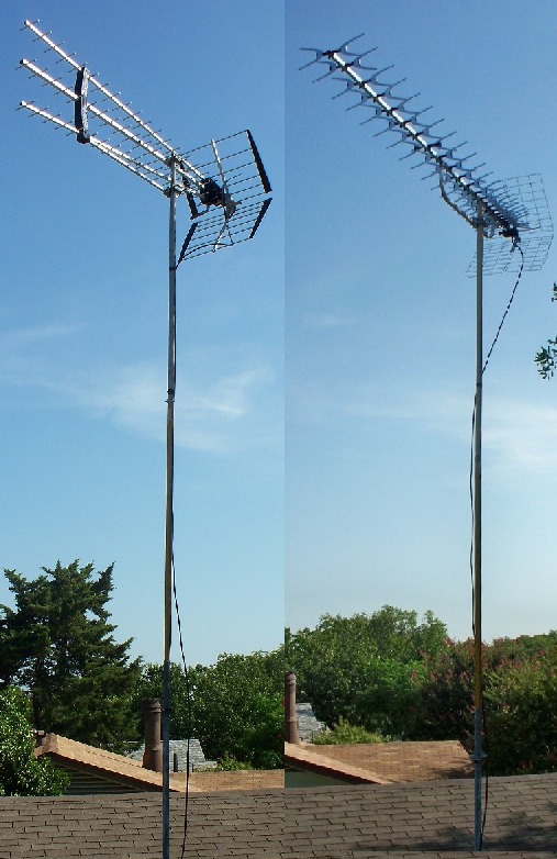

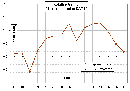

Televes DAT-75 vs. Antennas Direct 91XG
A pair of UHF antennas were compared:
Antennas Direct 91XG and Televes DAT-75
Both antennas have built-in baluns.
Equipment used in the tests:
- Push-up sectioned mast with two ~5 ft. extensions
- Fifty feet RG6 quad shield coaxial cable (CATV grade)
- Sencore SLM1456CM (Digital signal level meter)
The Sencore 1456 can scan channels, after each channel is locked-on and signal strength and quality measured, it tunes to the next channel and repeats until all channels have been analyzed. The 1456 saves the results as normal computer files, they can be downloaded for later analysis.
Signal sources: Multiple DTV stations in the Dallas/Fort Worth area. All stations generally located at the same bearing with LOS at ~29 miles.
The center boom of each antenna was raised to a height of 25 feet above ground (AGL).
The following is an image of the antennas in the test positions:
Test Sequence:
The tests were performed in mid-morning during a 2-day period. For each antenna test, the Sencore 1456 was allowed to scan available UHF stations three times. The first day there were 3 scans for each antenna for a total of 6 scans. On the 2nd day, the tests were repeated for 12 more scans.
A recording (run) consists of the SLM1456CM scanning the UHF band and recording the average signal strength (dBmV) for each channel.
Day 1: 3 consecutive runs with 91XG followed by 3 runs of DAT-75
Day 2: 3 consecutive runs with 91XG followed by 3 runs of DAT-75, then 3 consecutive runs with DAT-75 followed by 3 runs of xg-91.
In all, there were 3 sets of 3 scans for each antenna. Each scan took ~2-3 minutes. So the measurements were no more than 2-3 minutes apart
The results were downloaded and graphed in Excel. All 9 runs for each antenna were averaged together to yield a composite, shown here:
Observing that the 91XG provided the overall highest received signal power, the difference was computed and graphed in the image below:
The 91XG had about 1 dB more gain for the mid portion of the UHF band.
The two antennas were nearly equal at the lower channels.
These results can be rationalized as follows:
The DAT-75
- Large reflector & essentially a stacked pair of driven elements provide lower frequency gain.
- The 3-stack spacing becomes wider (in terms of wavelength) at upper frequencies, increasing gain.
The 91XG
- Colinear directors (X directors) and long boom length provide high gain thru the band.

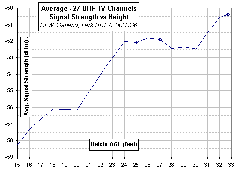

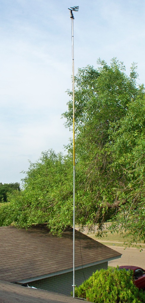

UHF Signal Strength vs Antenna Height (AGL)
In May 2012, Bob Nelson (forum member re_nelson) and I performed some experiments to observe the effects (in a suburban area) of UHF signal strength versus height of an antenna.
Signal strength measurements of 27 DTV stations versus receiver antenna height were recorded. On average, signal strength increased with height increase. Individual stations showed variability of signal strength (in a repeating pattern), this could indicate the presence of signal layering. Signal layering can result from reflections (ground or other) that either reinforce or reduce signal strength at various receiver antenna heights.
Location: Garland, TX
Signal Path: Line-of-Sight, about 28 miles from TV stations located at Cedar Hill, TX.
Local Clutter: Single story residential homes with some trees (approximately 30 –45 feet tall). The LOS path was essentially between any tall trees.
Signal Sources:
At that time there were 27 DTV stations in the same general azimuth direction that could be received at this location. These 27 stations served as stable signal sources to compare strengths at various antenna heights.
Equipment:
Antenna: Terk HDTVi mounted to a push-up mast. The HDTVi was chosen because of it’s small aperture (allowing better height resolution), small size, and relatively flat response across the band. The HDTVi is shown in image below.
Mast: A push-up mast capable of being quickly lowered or elevated up to about 45 feet. The mast had numerical marks on it every foot for quick determination of height.
Signal Analyzer: Sencore 1456, capable of scanning the UHF TV band for signals and measuring and recording the amplitude and MER (quality).
Coaxial Cable: Fifty feet of commercial quad shield RG-6 with custom connectors.
Methodology:
Beginning at 15 feet AGL, measurements of all measurable* signals were taken at close intervals up to a height of 33 feet AGL. Most measurements were made at 1 foot intervals, between 18 and 24 feet, the measurements were made at 2 feet intervals.
* All stations had adequate signal strength, but some were low power (LP). For a few reasons, LP stations among several full power stations are difficult for an analyzer (tuner) to reliably decode. However signal strength measurements were feasible. The entire UHF TV band (Channel 14-51) is well represented by measurable signals.
Below is a chart showing the average signal level of 27 UHF channels versus height.
Each point in the graph represents that average signal strength of 27 DTV stations (RF channels) at that particular height (AGL). The averaging process takes out a lot of information, but does help provide an overall view.
The graph shows there is a signal strength plateau around 24 feet. But, increases resume at heights greater than 30 feet. Interestingly, the FCC uses 30 feet AGL for outside antenna in many propagation/contour analyses.
Much appreciation to re_nelson for his assistance, equipment, and support.
Later, the data illustrating signal strength versus height for individual stations can be graphed and posted, in a few weeks maybe sooner.

tripelo,
Interesting exercise.
I experienced a similar phenomenon when I moved my single HDB8-X from my aluminum HAM tower leg (@ ~19’ AGL) to my TV tower mast (@ ~40’ AGL). Most stations got stronger (marginally), some stayed about the same, I lost one and picked up a couple of others. When I added a second HDB8-X to my TV tower array most channels signal strength improved 1-2 dB but at least one actually appeared to get weaker? The two HDB8-X’s are vertically stacked.
