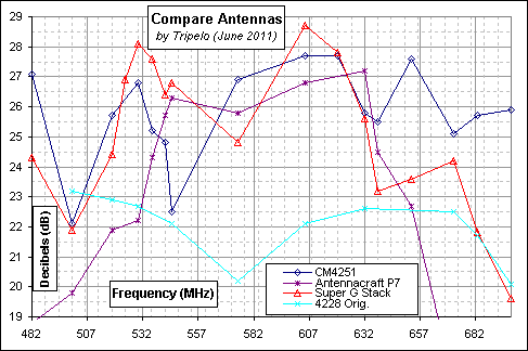

Tests were conducted in 2011 to evaluate performance of some TV antennas.
The tests involved a signal source feeding a CM-4228 at ~45 ft AGL radiating to antenna under test located ~150 feet distant at ~level height to source antenna.
The signal source was a homebrew signal synthesizer, remotely controlled at the receiving location by a notebook PC.
Received signals from the test antenna were measured using a homebrew wideband power meter with digital readout and logged into an Excel spreadsheet.
The test frequencies were chosen to represent channels that might be of personal interest.
This location is rural, the only UHF strong signal is at Channel 14; the frequency band was omitted from the tests.
The last image below shows results from comparing four antennas:
- Channel Master 4228 (the most common of the older versions)
- Channel Master 4251
- Antennacraft P7
- Antennacraft SuperG 1483 (the stacked Hooverman version)
http://forum.tvfool.com/attachment.p...5&d=1364921502
http://forum.tvfool.com/attachment.p...7&d=1364923084
http://forum.tvfool.com/attachment.p...4&d=1364921475
The decibel scale is relative for a comparison between the units.
Caveats:
Each antenna was installed at the test mast for a few days while several preamps were individually tested with that particular antenna. So, each antenna was measured days apart from others.
There may be some SWR effects in the antenna gain patterns, affecting each antenna differently.
Comments:
In general, testing against distant weak TV signals was consistent with the measured results. CM-4251 was best on upper UHF. P7 performed well on mid UHF channels. SuperG 1483 was comparably good on mid-20 range channels.
Attachment 496

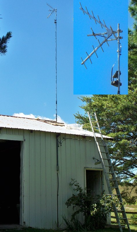

Below is an image taken in 2011 around the time of the preceding test. The workbench is behind that window, inside the building next to the receiving antenna mast.
http://forum.tvfool.com/attachment.p...8&d=1365093205
Shown on part of the workbench, among cables, planks, and bricks; from top to bottom, left to right:

The near tower has the transmitting CM-4228. Hard to see, it is mounted directly behind the CM-4251. The tower and that particular CM4251 have stood for more than 40 years.

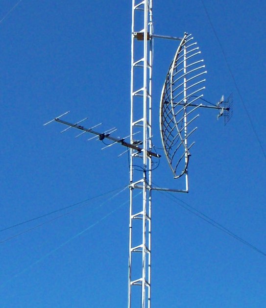

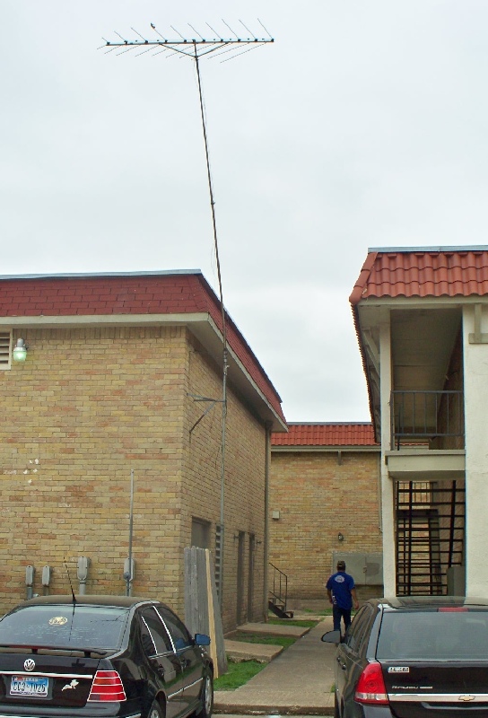

In the meantime, this is an image taken in 2009 of the main tower (lower part shown in Post #1) as it has stood since I personally erected/installed in the early 1970's. The tower and antennas were largely ignored all those years, (meaning almost no maintenance), although they reliably provided TV reception for my parents.
The large VHF antenna is a Channel Master Quantum CM-1110.
The plastic bucket lodged in the tower was there temporarily for convenience to hold tools and such. The photo was taken just before the CM-1100 was lowered to the ground.
Since that time in 2009, there have been several different antennas residing above the tower top, or near the top of the tower. Maybe later can show some of the other antenna arrangements.

As I said in my last post, the CM-4228 was on a push-up mast with a rotor and was using the HDP-269. I ordered a Winegard YA-1713 Prostar 1000 10 El. Hi-Band VHF Antenna to go with it.
I thought I would use that combination to test the Winegard pre-amplifiers that overloaded with my tower array.
I installed the YA 1713 above the CM-4228 and ran two new 17’ pieces of RG-6 down the mast, one from the CM-4228 (white) and the other from the YA-1713 (black), so I could experiment with UVSJ's, my HDP-269 and AP-2870, and several cable drop amps I’ve collected without having to lower the mast for each change. In anticipation of testing the pre-amps, I ordered three Antennas Direct FM Band 20 dB traps and two 3 dB & two 6 dB in-line attenuators to go with my Channel Plus 55 dB channel 26 notch filter.
When I got everything hooked-up, the new Winegard YA-1713 wouldn’t receive channels 7 or 13. It is mounted about 30’ south and 6’ lower than my Antenna Craft Y10-7-13.
When it wouldn’t work with my amps., I hooked it directly to the cable that runs to my PCT-MA2-4P distribution amp. and was able to receive 8 (8.1) & 10 (10.1) out of San Diego and 9 (9.1) & 11 (11.1) from LA. I then disconnected the YA-1713 and hooked up my Channel Master CM-4228 to the cable that runs to the PCT-MA2-4P distribution amp. and got a very pixelated channel 7, a fairly solid 9, intermittent 11 and a pretty good 13. All 4 LA stations measured high “Green” on my SNR meter with the Antenna Craft Y10-7-13 switched in (of course it has a +15 dB MA2-M mounted right behind it). Adding an amplifier to the Winegard 1713, at the base of the push-up didn’t improve/add the missing LA stations. It did considerably improve VHF reception from the CM-4228.
Since I only had one 50’ run of RG-6 going from the base of the push-up mast into the garage, I had to get up on the roof to switch antennas. I added a second run (white) so I could route the UHF and VHF signals to a garage coax switch separately. After I got tired of running out to the garage to switch between antennas I added a 4th RG-6 run into my office so I could monitor both push-up antenna signals from the office. That’s kind of where I’m at right now. With no amplifiers in-line, the 4228 actually does better getting channels 7 & 13 than the YA-1713. Mid-band, the YA-1713 does better.
I sent Winegard an email on May 13th to see if they could think of any reason performance would roll off that dramatically at the top & bottom of the YA-1713’s band. So far I haven’t heard back from them. They probably got the email and thought I was nuts!
Solid Signal sent me an email flyer for an 8-Bay “Solid Signal Xtreme Signal HDB8X High Definition Blade 8 Bay Xtreme Antenna (HDB8X)” for $59.99 with $0.05 shipping. It looks to be 2 4-Bays on a swivel with 2-BALUM’s hooked to a combiner. It has the multi-directional feature like the new Antennas Direct DB8e and blade elements similar to the 91XG. For $60.04 delivered I couldn’t resist. They claim a maximum gain of 25 dB when both sides of antenna are parallel, which I believe defies the laws of physics, but if their matching harness arrangement is any good at all, I expect it will perform about as good as any other 8-Bay. They don’t expect to ship them until after 1 June.
Next, I want to pull down the push-up, inspect the YA-1713 and swap the 17’ cables. I’ll probably also try it on my tower and try the Antenna Craft Y10-7-13 on the push-up.
I can’t drop or raise the push-up mast by myself. I have to set a ladder in front of it so I can reach the U-bolt through the upper stand-off bracket. Once I get the U-Bolt off I need somebody to hold it while I move the ladder out of the way so it can be laid horizontal. Going back up, I need somebody to hold it so I can position the ladder and re-install the U-Bolt. There’s a real shortage of people in my neighborhood lining up to climb on a roof to raise & lower antennas! Since I’ll want to try the new 8-Bay anyhow, I’ll probably wait until the HDB8X gets here to do any more YA-1713 testing.
The tower got too heavy to lift, even with help, so now I can lower and raise it by myself with help from a 110 VAC winch. When I have the new patio roof put on I’ll try to figure a way to get winch’s working for the push-up and my other tower.

Pete, looked back at your tower array, mentioned in your earlier post.
Direct link to post #3348 here:
http://www.digitalhome.ca/forum/show...postcount=3348
As to why the poor reception of the YA-1713 for VHF compared to the 4228:
Not a lot of suggestions, there are several variables.
The YA-1713 and most antennas have a bit less gain at the band edges (in this case; channel 7 and 13). If there were extra attenuation in the YA-1713 path, then the normal roll-off of the gain vs frequency pattern for the YA-1713 could become more obvious.
As you mentioned, reversing the cables between the CM4228 and the YA-1713 seems a good step.
If you have cables with pre-installed factory connectors, they sometimes cause problems.
The YA-1713 has a snap on balun that could have a problem.
Your thoughts on the new 8-bay (Solid Signal HDB8X) will be interesting. Since it has separate reflectors (not-continuous like the 4228) then it will probably have less response for your VHF signals.

tripelo,
I made up both of the 17’ cables going to the antennas just to simplify testing. Since I still had both white & black rolls of coax, I arbitrarily used white for the UHF run & black for the VHF run. I installed the boot that came with the YA-1713 on the black cable & new Channel Master (PCT) compression connectors on both. I doubt that I have a bad connection on the black cable but that’s why I want to swap them.
The original black cable that runs into the garage is probably 30 years old with crimp on connectors. It is the one I originally used to compare both antennas so I’m pretty sure it is still Ok. The “new” cable I pulled is a 50’ “factory” Magnavox M61210 roll of white RG-6 with molded ends that my son gave me. I have swapped the antenna feeds between both of the garage runs and can’t tell any difference so I’m pretty sure both of those are Ok.
The 4 cables from the garage to my office are new RG-6 runs with compression connectors that are routed between the downstairs ceiling and the upstairs flooring through PVC conduit, then down through the office wall to a metal plate with 4 F-81 barrels.
The YA-1713 balum looked like it could install either of two ways so I checked online with Winegard and found that it didn’t make any difference. I didn’t pay a lot of attention to it but as near as I remember it just looked like a clip-on microstrip line matching transformer. It should have been foolproof. If I can get it apart without destroying the plastic housing I’ll inspect it for any signs of damage or missing parts.
I think the most informative test will be dropping the tower and swapping the VHF antenna locations. That will put the YA-1713 in a known good signal location with plenty of amplifier gain and all new end-to-end proven cables.
Of course I want to compare the HDB8X to my 40 year old Channel Master CM-4228. That may not sound fair, but last summer I compared the 4228 to a brand new 91XG and in the same location both antennas provided about the same SNR +/- ~1 dB on most channels. I also want to see how it does on channel 36 (4.1 NBC) & channel 43 (2.1 CBS) since the 91XG has trouble with NBC & the 4228 has trouble with CBS (from the same location).
My San Diego UHF stations arrive from ~169 deg. and seem pretty strong. One of the things I also want to try with the HDB8X is pointing one panel towards San Diego and the other towards LA (292 deg.) and see how the 4-Bays do through the combiner and/or individually. That’s assuming that they will swivel through 123 deg. Fortunately, I have the rotors so if I don’t get the angle set to exactly 123 deg. I can “bump” align each panel for best signal.
I’ll be waiting to hear how you climbed “above the top of the tower”.

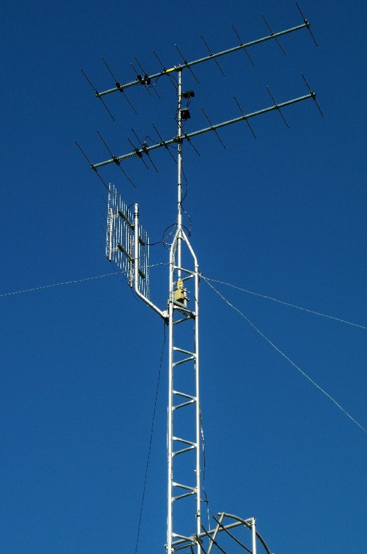

This is a photo of the antennas that replaced the CM-1110.
http://forum.tvfool.com/attachment.p...8&d=1369571323
The only objective of the VHF antennas was to better receive WKYT (at that time RF channel 13), 74 miles distant, 2-edge diffraction according to TVfool.
The configuration:
- Two Winegard YA-1713, stacked
- Combiner; Winegard CC-7870
- Spacing; 43 inches (was varied +/- 18 inches while watching Signal Meter)
- Mast length; 10.5 feet, ~ 7.5 feet above tower.
(Made from heavy duty top fence rail (SS-20, ~1 & 3/8 inch outer diameter)
- Channel Master antenna rotator moved inside tower for stability.
- Final Preamp, Channel Master CM-7777 (original), a WG-3700 was tested
- All cables RG-6, custom installed connectors.
In 2010, WKYT changed RF channels from VHF 13 to UHF 36, so the YA-1713s were not of much use after that.
The configuration stayed in place for approximately a year, until ~mid 2010.

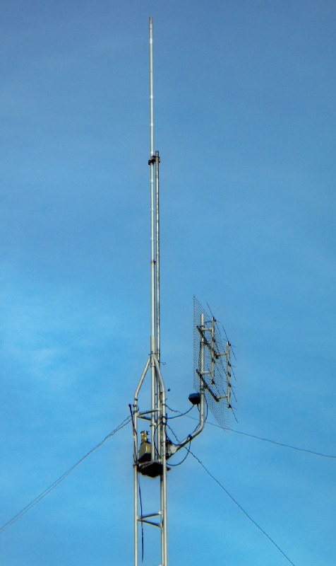

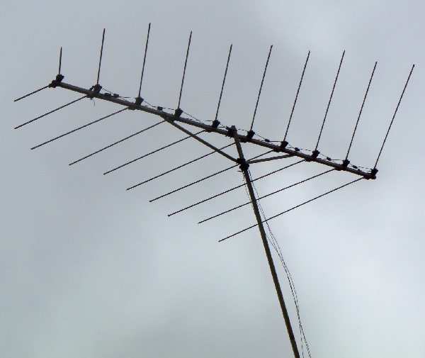

The following image shows an 8-bay antenna that was purchased in 1970. Pretty sure it is Channel Master, probably a precedent to the popular ’original’ CM-4228. The physical dimensions and construction are different. Note the differing transmission line feeding the right and left 4-bays, it extends downward. The antenna demonstrated about 0.5 dB better gain on low to mid UHF channels than the popular ‘original’ CM-4228. No comparison was made for upper channels.
That antenna was hit by a tornado in 1971, breaking a whisker (upper right). The tornado destroyed surrounding buildings, along with the tower and other antennas on it.
Note: People lost their lives and many homes were destroyed in that tornado.
The 8-bay whisker was repaired and it was placed in storage until 2010.
http://forum.tvfool.com/attachment.p...9&d=1370105543
Mid 2010, the antenna was installed to receive channel 22 WCTE at 65 miles distant. At that time WCTE was transmitting 57 kW ERP. TVfool showed the path diffraction as 2edge.
http://forum.tvfool.com/attachment.p...0&d=1370105556
For convenience and shorter preamp feed length, the 8-bay was mounted upside down.
The preamp was the UHF section of the CM-7777 (VHF portion in use for Yagis), using an 'inside' balun (with silicone waterproofing).
The Yagis and the CM-4251 already had their separate cables and were combined with UVSJ behind the TV. So, behind the TV, the 8-bay channel 22 signal was separated from CM-7777 coax with another UVSJ, then added back to CM-4251 UHF signals via a Channel Master Jointenna.
Although the reception was very good for WCTE, channel 22, this antenna configuration lasted only a few months.
