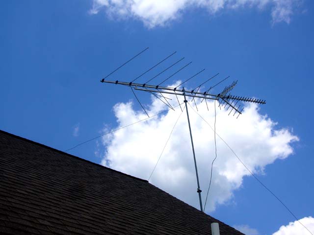

We already have an old antenna on the roof that came with the house, but it's in pretty sad shape, and doesn't pull in all the channels we want to get. We've aimed it in the direction of the towers, but it's still not enough.

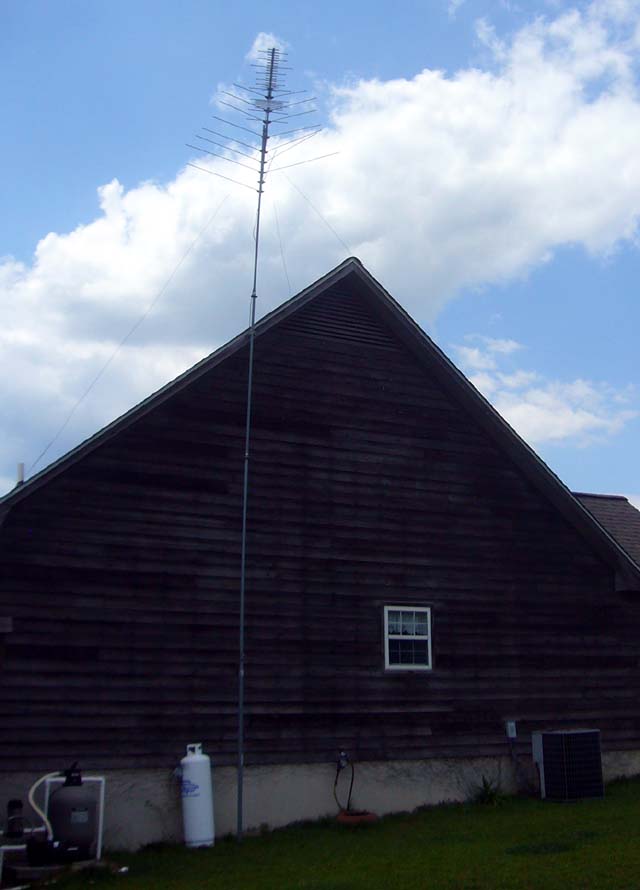

Here are a couple of shots of the existing antenna in case that helps:
We've been up there and straightened the few elements that are off, but the first good strong wind and they're back against the boom.
Based on reading we've done here and elsewhere, we're thinking we'll need something along the lines of the Winegard 7698P or maybe even the Winegard HD8200U. Are we on the right track? Do we need this extreme fringe class of antenna, or would a smaller one suffice? Are there better alternatives?

It looks like all the receivable Digital Tv station networks , without duplicating any Digital networks , are available with a Winegard HD7698P antenna aimed one direction.
Aim a HD7698P antenna at about 126 degree magnetic compass direction.
