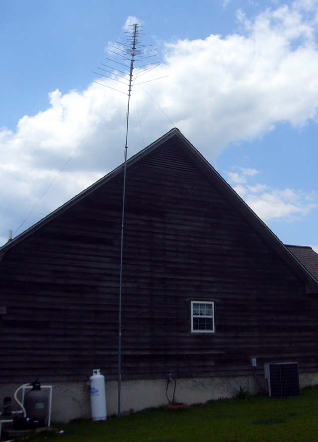

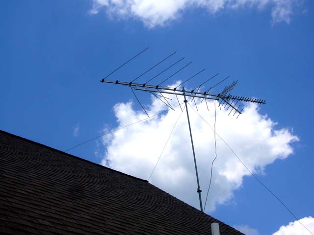

We already have an old antenna on the roof that came with the house, but it's in pretty sad shape, and doesn't pull in all the channels we want to get. We've aimed it in the direction of the towers, but it's still not enough.

Here are a couple of shots of the existing antenna in case that helps:
Attachment 538
Attachment 539
We've been up there and straightened the few elements that are off, but the first good strong wind and they're back against the boom.
