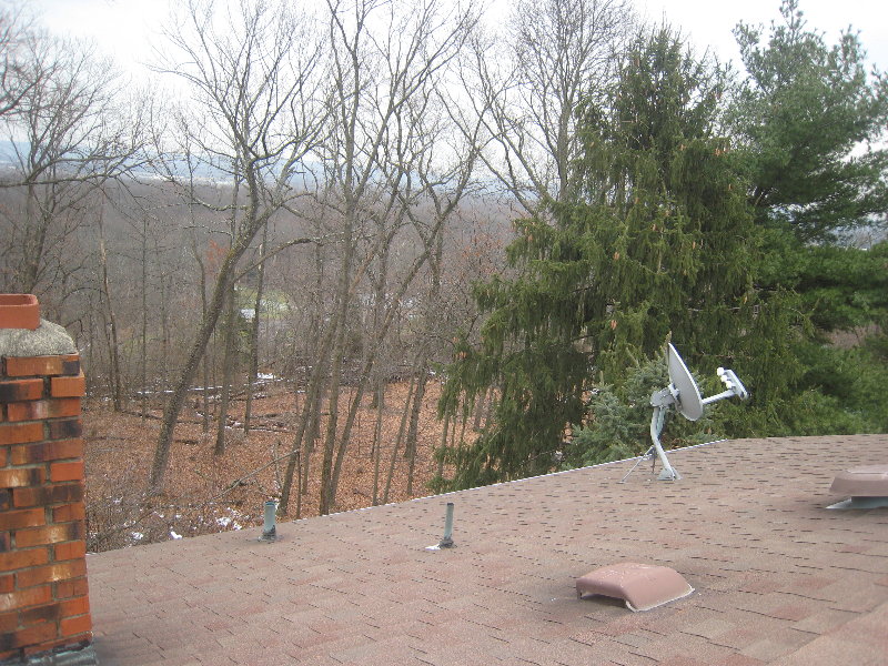

Here is a pic from my roof facing east / south east (my guesstimate of your 125 suggestion... looking now at a compass online though I think this is more like a 140 degrees angle):
Also you can see the old DirecTV mount and dish (should I mount off of this existing mounting?)
So the only obstruction is from trees, not from the house or roof or other buildings. The largest tree there is an Elm that is dead and will be coming down, with that lean I can't believe Sandy didn't take it down. Several of the tall skinny trees will be coming down too. The conifers, however, are staying
and also how many channels do you think I might be able to pick up? Would it be possible to pick up all of the greens? Also there are several channels I would need that are in the yellow section, think I can grab those? local CBS, FOX etc

Do not use the satellite mount.
Do a chimney mount or tripod mount.
If using a tripod mount , keep the tripod mount and antenna away from the evergreen trees. Tv antennas like a nice clear view of Tv transmitters.

As for easy to do, actually, yes. You're pretty close to some broadcast towers, so aiming the antenna in the general direction will probably work fine. However, a compass using the degree coordinates on your plot will help you zero in on the best signal for a given channel. That's your starting point. Connect to the TV over coax and have it scan for antenna channels. Most HDTV's will have a signal strength indicator of some sort. You won't typically be able to tune all at 100%, so you have to find the sweet spot that gives you good strength on all that you want to watch.
teleview has given you a good antenna recommendation and tuning advice as well. Either way, you are going to tune a lot of networks. If you don't know, most have sub channels as well; 3.1, 3.2, etc. So you'll get a lot of channels.
You have some trees, but if they're a good ways away, you'll be fine. The conifers are consistent, so you can tune most any time of year and be done. Summer when the deciduous are in "full sail", that can change things. Just like the dish, the clearer the view of the sky, the better. The dish only needed a hole to peek through where the antenna likes a clean horizon, so typically height helps you.

I like the suggestion made by @teleview, to use your chimney as the base for your antenna installation. A good quality chimney mount kit will easily hold a 10' mast section with no guy-wires needed. Putting the antenna up high, clear of smoke from the chimney will make the antenna last longer and improve your reception compared to a lower mounting.
If you are intending to record at some point, you'll want to err on the side of reliable signal quality. The HD7000R suggested earlier is a good antenna, but if you opt for a bit larger antenna such as the HD7080P (or even larger 7082 & 7084), you'll add insurance against signal dropout caused by close-in foliage.
