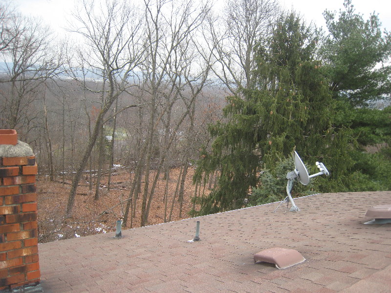

greenguy 30-Nov-2012 7:29 PM
1 Attachment(s)
Thank you. Do you guys have any recommendation on DVRs?
Here is a pic from my roof facing east / south east (my guesstimate of your 125 suggestion... looking now at a compass online though I think this is more like a 140 degrees angle):
http://forum.tvfool.com/attachment.p...6&d=1354303423
Also you can see the old DirecTV mount and dish (should I mount off of this existing mounting?)
So the only obstruction is from trees, not from the house or roof or other buildings. The largest tree there is an Elm that is dead and will be coming down, with that lean I can't believe Sandy didn't take it down. Several of the tall skinny trees will be coming down too. The conifers, however, are staying
and also how many channels do you think I might be able to pick up? Would it be possible to pick up all of the greens? Also there are several channels I would need that are in the yellow section, think I can grab those? local CBS, FOX etc
teleview 30-Nov-2012 7:46 PM
Do not use the satellite mount.
Do a chimney mount or tripod mount.
If using a tripod mount , keep the tripod mount and antenna away from the evergreen trees. Tv antennas like a nice clear view of Tv transmitters.

I am glad to help out. I'm no antenna guru, but I have installed and played with a few over the last several years. I dropped my sat service around 5 years ago in favor of the antenna. Haven't regretted it either.
As for easy to do, actually, yes. You're pretty close to some broadcast towers, so aiming the antenna in the general direction will probably work fine. However, a compass using the degree coordinates on your plot will help you zero in on the best signal for a given channel. That's your starting point. Connect to the TV over coax and have it scan for antenna channels. Most HDTV's will have a signal strength indicator of some sort. You won't typically be able to tune all at 100%, so you have to find the sweet spot that gives you good strength on all that you want to watch.
teleview has given you a good antenna recommendation and tuning advice as well. Either way, you are going to tune a lot of networks. If you don't know, most have sub channels as well; 3.1, 3.2, etc. So you'll get a lot of channels. :)
You have some trees, but if they're a good ways away, you'll be fine. The conifers are consistent, so you can tune most any time of year and be done. Summer when the deciduous are in "full sail", that can change things. Just like the dish, the clearer the view of the sky, the better. The dish only needed a hole to peek through where the antenna likes a clean horizon, so typically height helps you.
As for DVR's, I use Windows Media Center on a PC that connects to my TV over HDMI. I put my TV signals on my network using HDHomeruns. Any PC in the house can watch TV using an included app. That's a bit more technical for the average house, but it works pretty well for us. Other DVR options are available from Channel Master & Tivo. I don't have any experience with those devices. I think the Tivo is cheap, but it has a monthly fee. The CM I think is more expensive, but no monthly required. There's also something I saw not long ago called SimpleTV. It can record and then stream to popular devices. It's got a $5 monthly fee I think. And solutions keep coming too.

greenguy 25-Feb-2013 9:50 PM
Originally Posted by GroundUrMast (Post 35320)
For an attic install that will be fine. If there is a little extra wire sticking out of a connector, you could cut a bit of the extra off, then take it to a big box home center and compare it to their #10 wire. I own wire strippers that have specific notches for each common wire size, the tool makes a good gauge. If you have a machinist caliper. #10 AWG is 0.1019" in diameter. http://en.wikipedia.org/wiki/American_wire_gauge
If the satellite system was installed using the smaller #12 or #14 ground wire you're better off than most (though the installation would not conform to NEC 810.21).
If you mount outside, I'd encourage you take the time to ground both the mast and the coax shield using a minimum diameter of #10 AWG copper.
good idea on the caliper and the correct measurement to look for! I think my stripper has ranges like 8-10, 12-14 so that may not be accurate enough. I'll use the caliper to be sure.
I didn't notice a ground mounting point on the antenna, do I just use one of the nuts that I attach the antenna to the mast? or maybe where the coax leads attach to the antenna?
