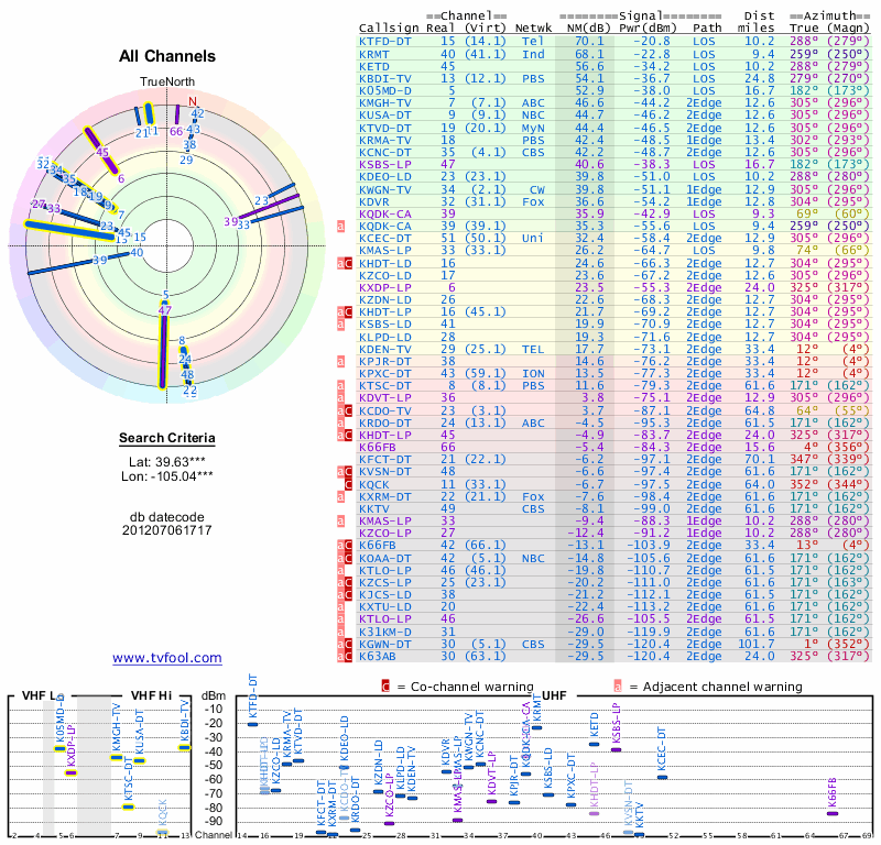

here's my channel listing map

http://www.tvfool.com/?option=com_wr...9900fac7e660ae
