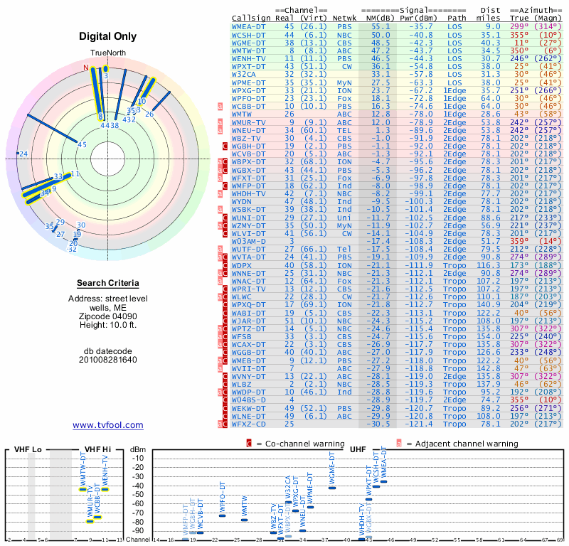

I have done a number of antennas in Southern Maine, and know the pitfalls. I am strongly against using an omnidirectional antenna, as they have no gain of their own, relying solely on an amplifier for gain, and they have no ability to reject multipath, which is a digital signal killer.
I have a very different take on what you need, and it has proven itself in a number of Southern Maine installations.
I would use a 2-antenna installation: an AntennasDirect DB4 UHF antenna along with an Winegard YA-6713 6-element VHF high-band antenna mounted on the same mast, separated by at least 4'. Combine the 2 antennas into one coaxial cable using a Pico-Macom UVSJ antenna joiner. If you follow these directions, you will see all the major networks including FOX, PBS and CW.
Aim the DB4 at 30 degrees, as measured by your compass, and aim the YA-6713 at 0 degrees: you'll see far more stations with this solution that you ever will with an omni-directional antenna, and your reception will be far more reliable in bad weather.
Please see the attached link for the results of a similar installation in Southern Maine

I'm 90% setup. I went with the AD DB4 UHF w/ WG YA-6713 VHF on the same mast. I get nearly all the channels I was looking for.
Here's a link to my TV fool report.
The one I'm missing is 26.1 (PBS), which is kinda odd since it's near the top of the list.
So, I'm looking at adding a pre-amp. Previously, mTownsend had suggested a Channel Master 7777, Winegard AP-8700, or Antennacraft 10G202. Given the channel I'm looking for, do you guys still think those are good suggestions? I read somewhere that you can get overload with strong nearby signals, but I'd like to try and pull in 26.1.

Nate, look at the radar plot on your TVFool report and I'll bet you will figure it out - that station is way off in a different direction. Remember that antenna gain varies tremendously by direction. The radar plot's value is in showing where you need antenna gain the most and where you need it the least.
Tigerbangs told you to point your DB4 at 30 degrees in order to put that antenna's peak gain in that direction with the hope that there would still be enough gain towards 26.1. Before you try a preamplifier, try turning the DB4 in towards north a little bit at a time to see if 26.1 pops in without losing anything else.

I think that Dave is probably right about channel 26: I have a feeling that you are just in an antenna null where you have the DB-4 aimed.
As far as PBS goes, can you pick up WCBB from Augusta decently?
WMEA is so close that I have to think that yours is a multipath issue and not a signal strength issue for you. If you decide to use a preamp, be sure to use a high-input preamp like a Winegard HDP-269, as you have enough signal arriving at the antenna to create an overload situation with many preamplifiers
