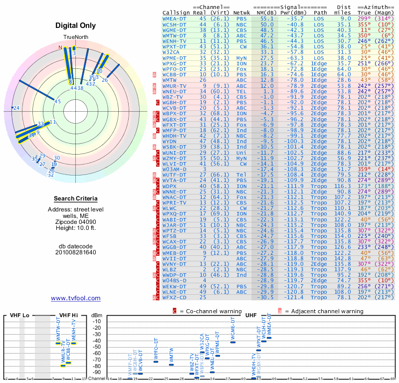

Hi, Friends.
I'd really appreciate some guidance on the right type of antenna for picking up digital tv signals over the air in my location. I've attached my TV Fool results.
The stations that TV Fool predicts in green are all we need: CBS, NBC, ABC and PBS.
Our home is surrounded by a perimeter of tall trees, but it's a "thin" perimeter, just a few trees thick…if that makes sense.
Thanks for any suggestions!
Attachment 90

Your strongest channels are coming from a lot of different directions. For this, I would suggest two possibilities:
1) Try an omni antenna like the Channel Master 3000A or Winegard MS-2000 on your roof.
Advantages: Omni design allows the antenna to pick up signals from multiple directions without having to adjust the antenna each time. NOTE: Antennas are never perfectly omni-directional, so even though it claims to be an omni antenna, you should still experiment a bit with aiming the antenna in different directions during initial installation for optimum reception.
Disadvantages: Omni antennas are susceptible to multipath (a.k.a., "ghosting", multiple signal "echoes" entering the antenna from all directions). This might make it more difficult for your tuner to lock on to some channels. Omni antennas also have relatively low gain intrinsic gain (not counting the gain of the built-in amplifier), so don't expect it to pull in the weaker, more distant stations.
2) Use a high gain antenna like the Winegard HD7696P and an antenna rotator like the Channel Master 9521A.
Advantages: High gain antennas are much better at dealing with multipath, so if your environment is susceptible to lots of multipath (usually places with lots of tall buildings, trees, and/or hills for the signals to bounce off of), these antennas can help clean up the signal. The high intrinsic gain of the antenna also makes it possible to pick up weaker, more distant stations, if you aim the antenna properly.
Disadvantages: You cannot pick up stations from a wide spread of directions at the same time. You need to turn the antenna each time you want to watch a different group of transmitters (e.g., Portland vs. Concord/Manchester stations).
Since you mentioned that you are only interested in the "green" stations on your list, I would start with an omni antenna first. However, if multipath turns out to be a big problem, you may need to switch to a more directional antenna later.
BTW, if you go with one of the larger directional antennas (i.e., HD7698P) and add a pre-amp (like the Channel Master 7777, Winegard AP-8700, or Antennacraft 10G202), you may even be able to pick up some of the stations from Boston.
One more note... Your report indicates that it was only resolved to "street level" accuracy. Perhaps the address lookup engine was not able to resolve your exact location. Just to make sure you have an accurate signal analysis, it would be best if you could re-run the analysis for your exact location. You can do this with the Interactive Maps tool (here). After entering your address, you can change the location of the signal analysis by dragging/dropping the orange marker until it is right on top of your house (switch the map to "satellite" or "hybrid" view for the best detail). When you are satisfied with the location and antenna height settings, you can click on the "Make Radar Plot" button to generate a new signal analysis report.

updated tvfool report
Thanks for all the detailed info, mtownsend! I updated my TV Fool report as you suggested.
Here's the link...
Seems like the more accurate TV Fool location for my house shows a weaker signal for at least one of the channels (CBS). Do you still think I'll be OK with your previous suggestions?...
Thanks!
mtownsend 21-Sep-2010 7:00 PM
I think the previous suggestion still stands.
Just be sure to get the antenna outside and up high. Your report was done with an assumed antenna height of 10 feet. It think you'll find that if you get the antenna up higher, the signal for most channels will get stronger.

I'm 90% setup. I went with the AD DB4 UHF w/ WG YA-6713 VHF on the same mast. I get nearly all the channels I was looking for.
Here's a link to my TV fool report.
The one I'm missing is 26.1 (PBS), which is kinda odd since it's near the top of the list.
So, I'm looking at adding a pre-amp. Previously, mTownsend had suggested a Channel Master 7777, Winegard AP-8700, or Antennacraft 10G202. Given the channel I'm looking for, do you guys still think those are good suggestions? I read somewhere that you can get overload with strong nearby signals, but I'd like to try and pull in 26.1.
Thanks for your thoughts!
Dave Loudin 26-Nov-2010 1:53 PM
Nate, look at the radar plot on your TVFool report and I'll bet you will figure it out - that station is way off in a different direction. Remember that antenna gain varies tremendously by direction. The radar plot's value is in showing where you need antenna gain the most and where you need it the least.
Tigerbangs told you to point your DB4 at 30 degrees in order to put that antenna's peak gain in that direction with the hope that there would still be enough gain towards 26.1. Before you try a preamplifier, try turning the DB4 in towards north a little bit at a time to see if 26.1 pops in without losing anything else.
Tigerbangs 26-Nov-2010 4:09 PM
I think that Dave is probably right about channel 26: I have a feeling that you are just in an antenna null where you have the DB-4 aimed.
As far as PBS goes, can you pick up WCBB from Augusta decently?
WMEA is so close that I have to think that yours is a multipath issue and not a signal strength issue for you. If you decide to use a preamp, be sure to use a high-input preamp like a Winegard HDP-269, as you have enough signal arriving at the antenna to create an overload situation with many preamplifiers
