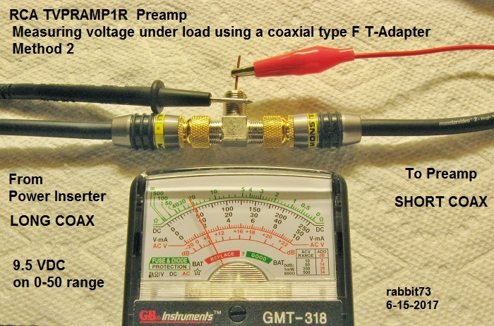

You said you had a preamp. A preamp needs power to operate, and a power inserter sends the power up to the preamp.
A preamp system comes in two parts: the preamp itself up by the antenna, and a power inserter down below. The power inserter makes it possible to send the DC power up to the preamp on the SAME coax that sends the signals down to the TV.
If something goes wrong with the power inserter, then it might not be able to send the power up to the preamp to make it amplify the signals.
It is possible to measure the voltage at the power inserter to see if the voltage is there without going up to the roof. Of course, that is only he first step in trouble shooting a preamp. The results of that test will determine what you need to do next.
Do you have a voltmeter, or do you have a buddy that can make electrical measurements?
Aha, yes. Mine is a Wineguard PS-1503.
I have a meter, and know basic electricity, but know nothing about how this system works. What/where should I check? Can this thing go haywire, correct itself overnight, be fine for a year or so, then go through the exact same cycle again?

Check the voltage now while it is working. If it goes out again, see if the red LED is ON or OFF.
You have an intermittent problem. I think you know how difficult that is------you have to catch it when it is acting up.
At this point, you don't know what is causing the problem. It could be the antenna, the balun between the antenna and the preamp, the preamp, the coax between the preamp and the power inserter (injector), the power inserter, or the power transformer. It could even be the signals.
Your job is to isolate the problem to one part of the system by substitution of known good components, even if it means a completely separate test antenna and coax.
Okay, transformer measures 29 V. and the "Ant" connection on the power inverter measures 16 V., both okay according to the video.

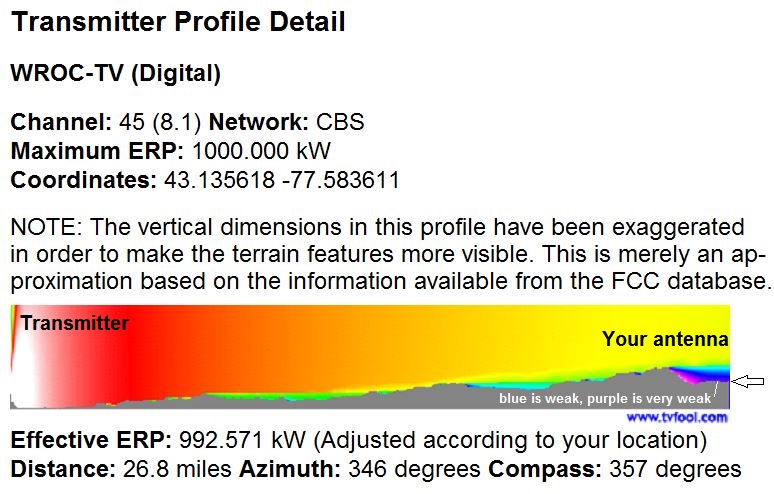

Thanks for checking the voltage to the preamp. If you have a problem again, check to see if the LED on the power inserter is still ON. as it should be, or OFF.
Thanks for the tvfool signal report.
http://www.tvfool.com/?option=com_wr...e6a4c5db6f4ec6
NBC, ABC, PBS always come in fine. CBS is normally fine, but if the antenna isn't aimed exactly it can be dicey, depending on the weather.
I only get FOX from around September/October until April/May.
That description exactly matches your signal report. NBC, ABC, and PBS are your strongest signals, and CBS is listed just a little weaker than PBS. Fox is a lot weaker than CBS.
CBS sends 992 kW out of 1000 kW ERP in your direction. If you click on the CBS callsign in your report, this is what you will see:
http://www.tvfool.com/?option=com_wr...dALLTV%26n%3d4

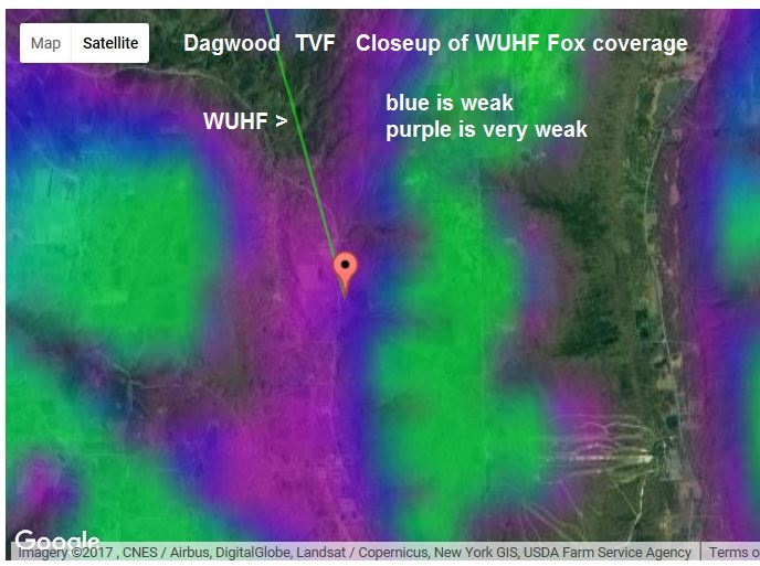

Fox is much weaker because it has a very directional transmitting antenna that sends only 11 kW out of 320 kW ERP.
http://www.tvfool.com/?option=com_wr...dALLTV%26n%3d5
I only get FOX from around September/October until April/May. It is like this every year, and was the same even before 2009 when it was analog. I assume it has something to do with the atmospheric changes as the seasons change. It does not correspond with the leaves being on or off the trees.
What you assume is correct; the seasonal change does make a difference. In the warmer weather, the Fox signal is not able to bend down to your location by refraction because the density of the air changes in warm weather.
Forum member tripelo says it much better than I can:
Daytime Signal Fade (Independent of Multipath)
Gradual bending allows radio signals to somewhat follow the earth’s curvature for some distance beyond normal line-of-sight. This gradual bending is somewhat independent of phenomenon like ‘tropo scatter’. As you know, long distance TV signals can fade (reduce in strength) in daylight hours. This can be due to smaller temperature gradients that result when the sun uniformly heats the air in the lower atmosphere during much of daytime hours. Smaller temperature gradients result in less bending of the signals back towards the surface, thus the daytime fade.
Note: Temperature is not the end cause of the bending of RF signals. Temperature is a measure of one particular driving factor (thermal energy) that can decrease atmospheric density, thus affecting the density of everything contained in the atmosphere (water vapor, etc).

Are there any trees in the signal path from Rochester?
Does the problem get worse when it rains?
My house is surrounded by thousands of acres of mature hardwoods, and there are tens of thousands of trees between me and the transmitters, although I'm guessing the hill between us, which is probably 500' higher in elevation than my house is, and 3-ish miles to the north, is more of a factor.
Yes, rain tends to make an edgy signal go out. But, and I bet there's a scientific reason for this, when I was on analog the signal came in better when it was raining.
EDIT: I see you added that image after I started this post. Yes, it all makes sense. This is the first time I've ever seen any hard science for all this. Before, all I ever heard was opinions and guesses from people who didn't necessarily know any more about it than I did.
Thanks! Gotta love the internet!
Dagwood is offline   Reply With Quote
Old 17-Sep-2017, 1:31 AM   #15
Trees block TV signals.
scroll down to Trees and UHF
Wet trees block TV signals even worse than dry trees.
With analog TV, the signals just got a little more snowy as they got weaker.
With digital TV, they suddenly drop out at a certain point as they get weaker. This point is called the "Digital Cliff."
The sudden dropout is caused by the FEC (Forward Error Correction system). The FEC is designed to correct the digital signal errors to maintain a good quality picture. As the digital signal gets weaker, there are more and more digital errors. The FEC has a limit to how many errors it can correct. Once that limit is exceeded, the FEC gives up, and the signal drops out.

I haven't had any more incidents of everything going completely out, but I am having reception problems.
As previously noted in this thread, I do not get FOX in the summertime but it always starts coming in around the end of September and lasts until maybe early May. This fall it didn't come in. So I've been on the roof numerous times rotating the antenna slightly either way. I have trees and a phone pole for reference points.
As time went on it started coming in, probably because the weather got colder, not from me adjusting the antenna.
So here we are in late November and I'm still having problems, not only with FOX but with CBS (my two weakest channels). I can't tell you how many times I've been on the roof (twice just today) and I'm getting tired of it. When winter sets in and there is snow on the roof, I will not go up there (too old for that stuff).
There has to be something wrong because I've never had problems like this, this late in the fall, since I installed everything new in 2011.
So tonight I re-checked the pre-amp, per the Wineguard clip that rabbit posted above.
Power supply, 27.6 V - good
"ANT" connection on injector, 15.1 V - good
So the next step I guess is to check the coax that feeds the preamp on the roof. If that checks out good, what is my next step? I would assume the pre-amp itself is maybe weak, but is there a way of checking that? TIA.

Hello again, Dagwood
Sorry you are having more trouble. Those two channels are very weak; it doesn't take much to knock them out.
You told us about your power inserter, but you didn't tell us what model of preamp you have.
You also didn't tell us what antenna you have. If you don't know the make and model, can you show us a photo of your antenna?
One thing might be different now: The trees might be thicker and taller now, so even if the leaves have fallen, the signals might be having a harder time now getting through.
If your antenna is made by Winegard, this video will show you how to check the CB8269 balun /combiner:
https://www.youtube.com/watch?v=TlQk...ule1MX8jCAfvPQ

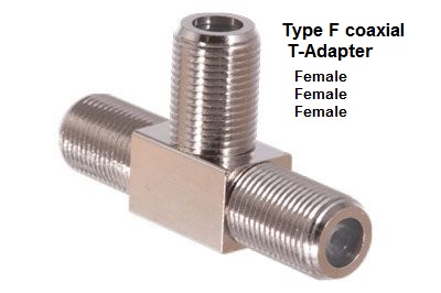

You have checked the voltage coming out of the power inserter, but you haven't checked the voltage to the preamp at the upper end of the coax that connects to the preamp.
And you haven't checked the voltage to the preamp at the upper end of the coax when it is connected to the preamp. This is harder, because when you check the voltage to the preamp near the preamp when it is connected, you need access to the center conductor. I use a T-adapter for that:
This is for an RCA preamp, but the method is the same:
