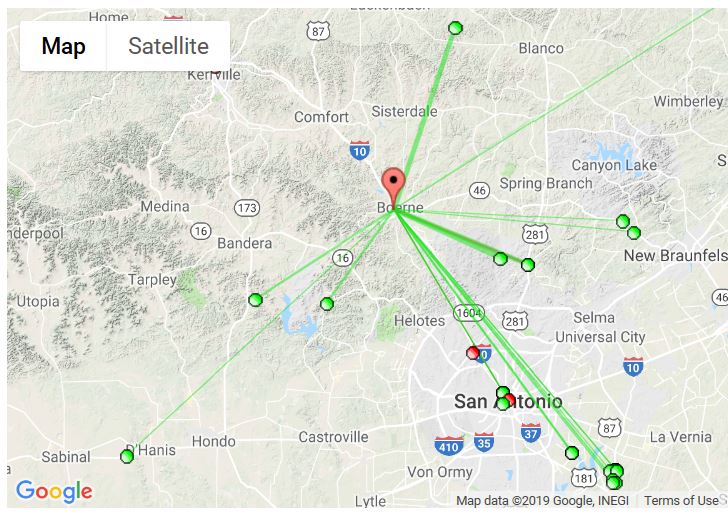

Thank you for the signal report. You say your antenna is 25ft high, but you used 10ft for your signal report. Please redo your report at 25 ft; it makes a difference with 2Edge signals.
A preamp will help with the weak 2Edge Fox signal at 140 degrees, but it might be overloaded by KNIC at 115 degrees. A more directional UHF antenna might be necessary. Try a medium gain preamp that is less likely to be overloaded than a high gain preamp, before switching antennas. Perhaps an Antennas Direct Juice or a Channel Master 7778.
ABC and PBS are VHF, so you might be able to use the 7694 just for VHF or have a separate VHF antenna.

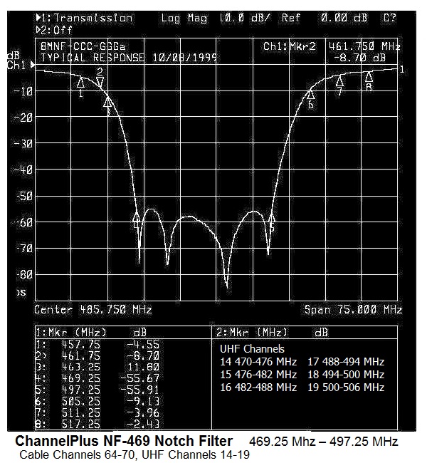

You need a preamp for the weaker channels from San Antonio, but KNIC is strong enough to cause overload. You could order a custom bandstop filter to attenuate real channel 18, but ChannelPlus makes a notch filter that is less expensive which might work.
Code:
                               Grounding
HD7694 > NF-469 > Juice > coax > Block > coax > Power > TV
                  Preamp                       Inserter
Grounding the coax with a grounding block makes the filter more effective.
