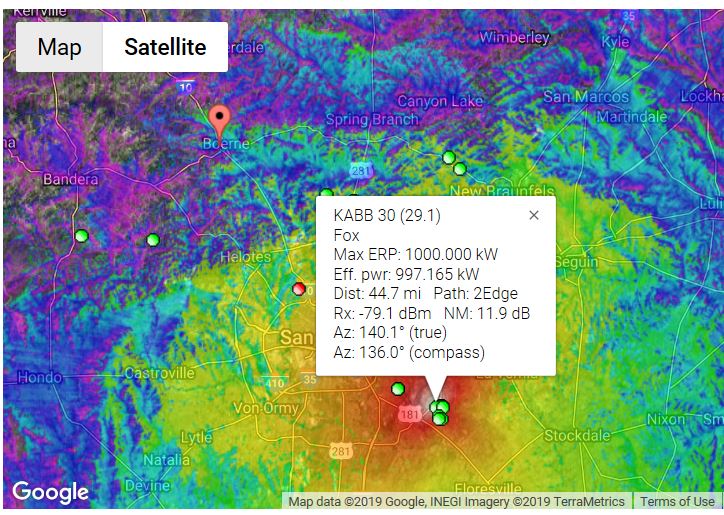

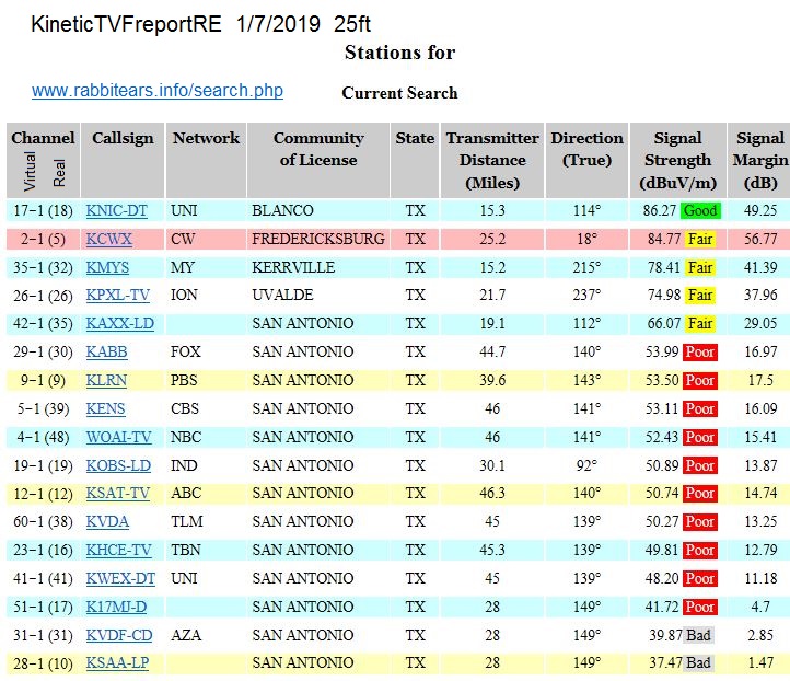

Thank you for the new report at 25ft.
WOAI NBC isn't on your TVFool report. As a double check, here is a report from rabbitears.info:
As a result of repack by the FCC, there will be some channel changes, as indicated by the arrows:
https://www.rabbitears.info/market.p...&callsign=WOAI
WOAI NBC will move from real channel 48 to 28.
KENS CBS from 39 to 29.
This is the repack plan for San Antonio:
Most of the changes will be during Phase 3, 4/13/2019 to 6/21/2019.
https://www.commlawcenter.com/2017/0...deadlines.html

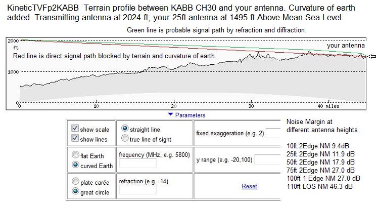

This is the terrain profile for KABB showing the terrain interference to the signal. Any increase in antenna height helps the signal clear the hills.
The TVFool Interactive map was used to show change in NM at various heights

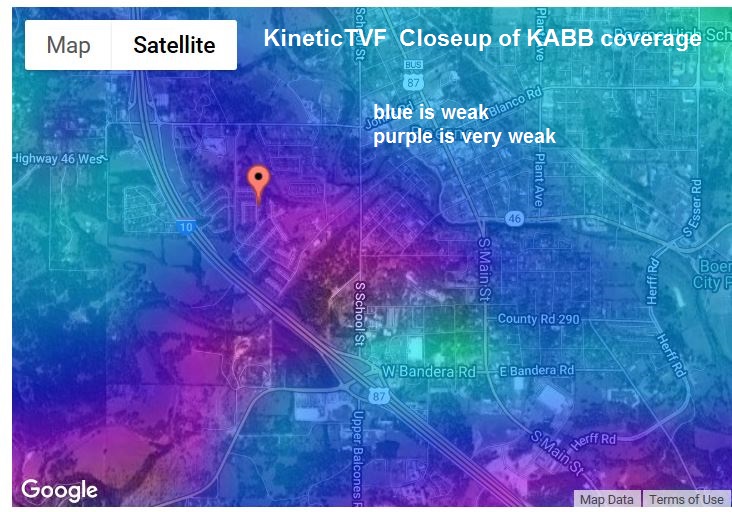

This shows the coverage of the KABB signal at your location:

I notice a significant difference between the signal level of KNIC calculated by tvfool.com and RabbitEars.info. Tvfool shows KNIC 48.3 dB stronger than FOX while RabbitEars says 32.3 dB. That makes it hard to determine if preamp overload would exist or not. I would doubt overload will occur with a Juice preamp.
