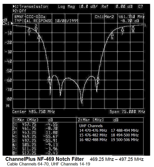

You need a preamp for the weaker channels from San Antonio, but KNIC is strong enough to cause overload. You could order a custom bandstop filter to attenuate real channel 18, but ChannelPlus makes a notch filter that is less expensive which might work.
http://forum.tvfool.com/attachment.p...1&d=1546991228
Code:
                              Grounding
HD7694 > NF-469 > Juice > coax > Block > coax > Power > TV
                  Preamp                      Inserter
Grounding the coax with a grounding block makes the filter more effective.
