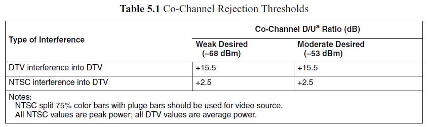

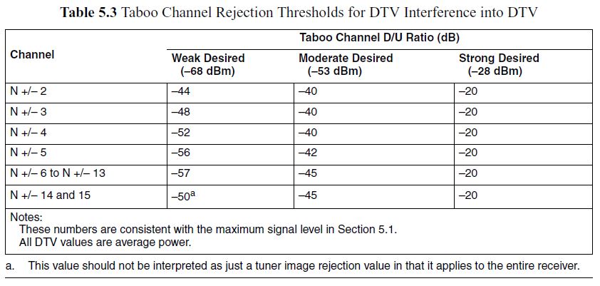

I think your chances are pretty good. WUWB NM 4.9 dB has co-channel interference from WOTV NM -17.7 dB (difference of 22.6 dB; must be 15.5 or more), and second adjacent channel interference from WNEM NM 47.6 dB (difference of 42.7 dB; must be 44 or less) on channel 22.

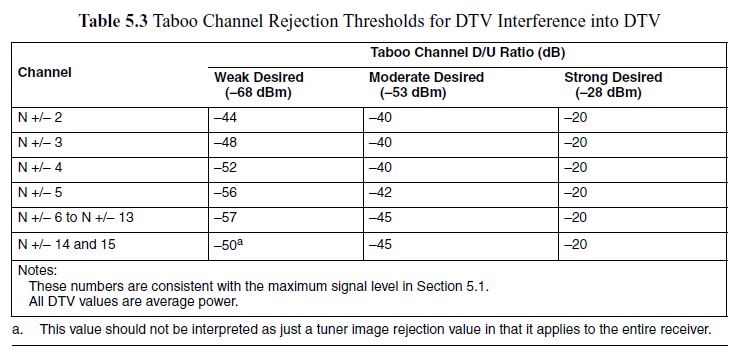

I agree with your evaluation on co-channel and 2nd adjacent (Taboo 2-away) channel interference.
ATSC Recommended Practice:
5.4.1 Co-Channel Rejection
The receiver should meet or exceed the following thresholds for rejection of co-channel interference at the following desired signal levels (Table 5.1).
5.4.3 Taboo Channel Rejection
The receiver should meet or exceed the following thresholds for rejection of taboo-channel interference at the desired signal levels (Table 5.3, 5.4)
