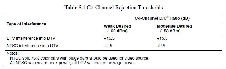

ATSC Recommended Practice:
5.4.1 Co-Channel Rejection
The receiver should meet or exceed the following thresholds for rejection of co-channel interference at the following desired signal levels (Table 5.1).
http://forum.tvfool.com/attachment.p...1&d=1436899996

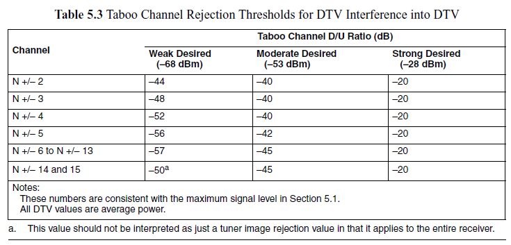

5.4.3 Taboo Channel Rejection
The receiver should meet or exceed the following thresholds for rejection of taboo-channel interference at the desired signal levels (Table 5.3, 5.4)
http://forum.tvfool.com/attachment.p...1&d=1436900220
