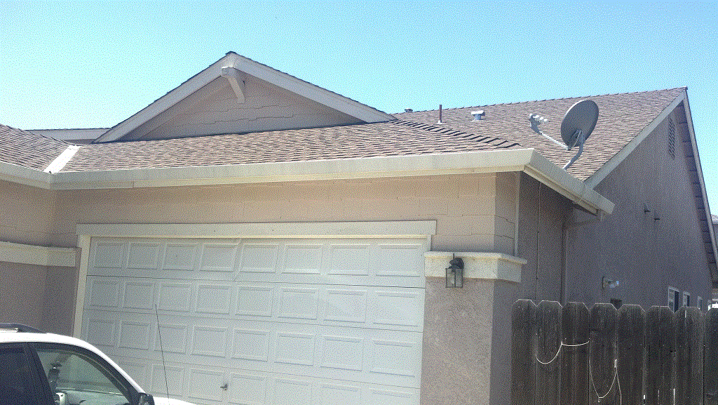

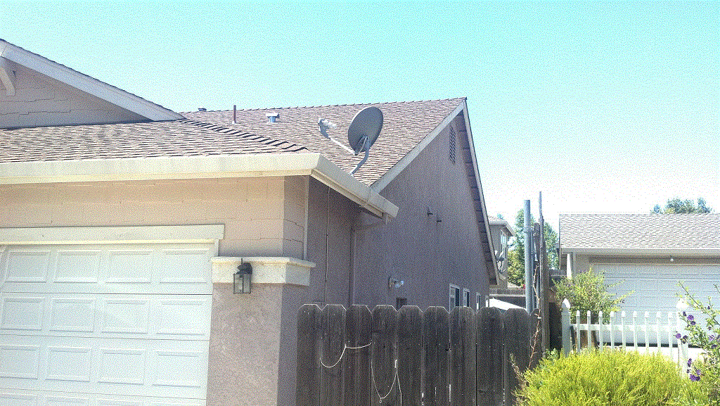

Here are some Pics of where my cable is coming from. Would this be a good spot or higher up on the eave?

Mount the Tv antenna so that the Tv antenna clears the high point of the house roof and clears the solar panels.

Gotcha, so I will just cancel all u-verse, they really arent that good and there pricing doesnt match the quality anyway. Then I will use the eave mount at the highest point of my roof which would clear everything. Is this mount pretty sturdy? What do you recommend? I do have a chimney but it is clear across the other side of my house.

The http://www.ronard.com/34424560.html.
Eave mount is Strong and Sturdy.
